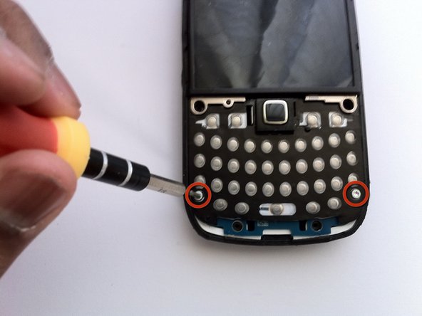

  • Using a Torx T6 Screwdriver, remove the indicated screws. There are 2 more in the top corners and at 2 bottom (not indicated in the picture). So a total of 6 scews are removed in this step.

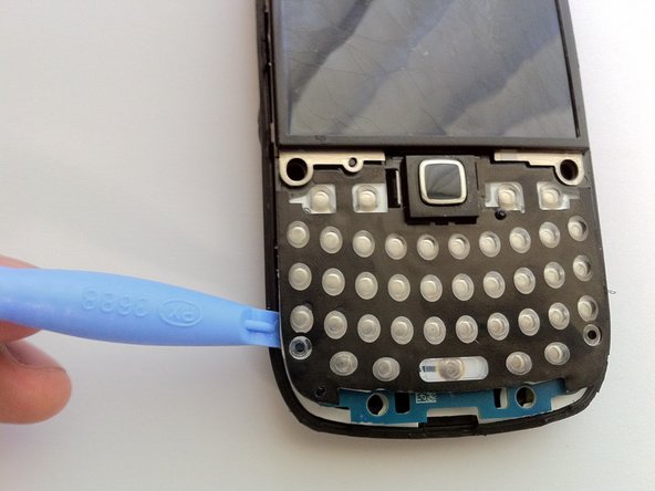

  • Using a plastic opening tool, gently pry the Logic Board Components from the device's frame.

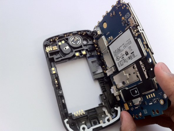

  • Once loose enough the Logic Board can be removed.
