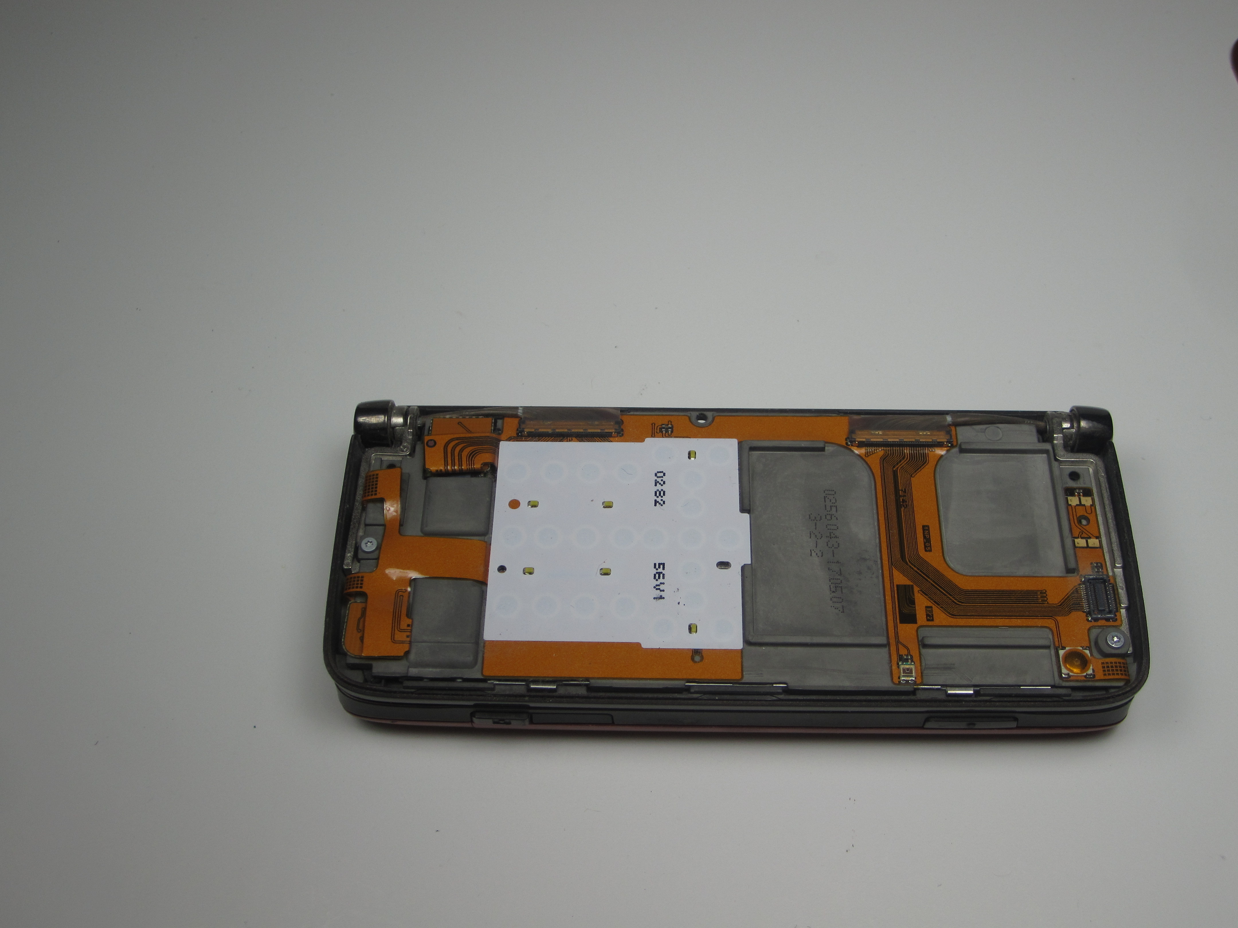

Add Note Edit Step 5 — Inside Screen  ¶
  • After removing the front screen and front keypad, your device should look like this.

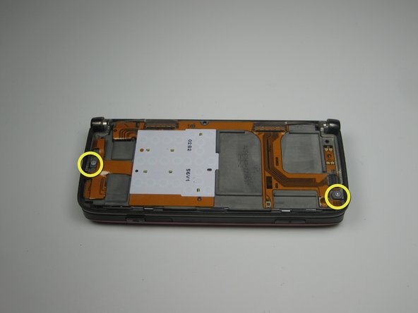

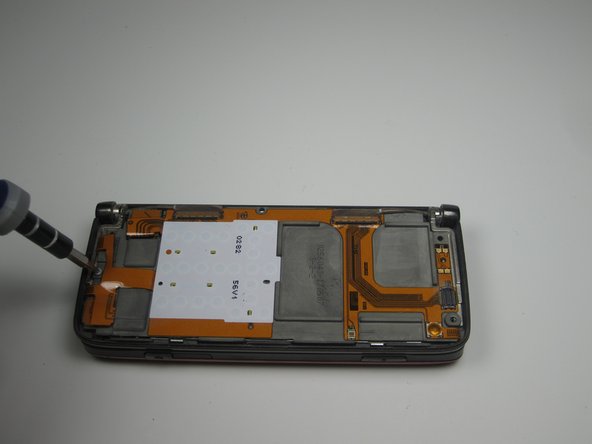

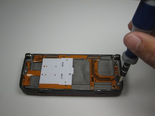

Add Note Edit Step 6  ¶
  • Using the T5 Screwdriver, remove the two screws shown.

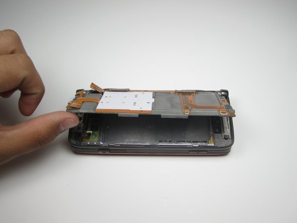

Add Note Edit Step 7  ¶
  • Make sure to remove the connection shown by gently easing the plastic opening tool underneath the connection and lightly prying the connection apart.
Image #1 Image #2

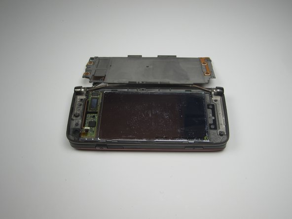

Add Note Edit Step 8  ¶
  • Gently, lift the board up to reveal the front screen.
