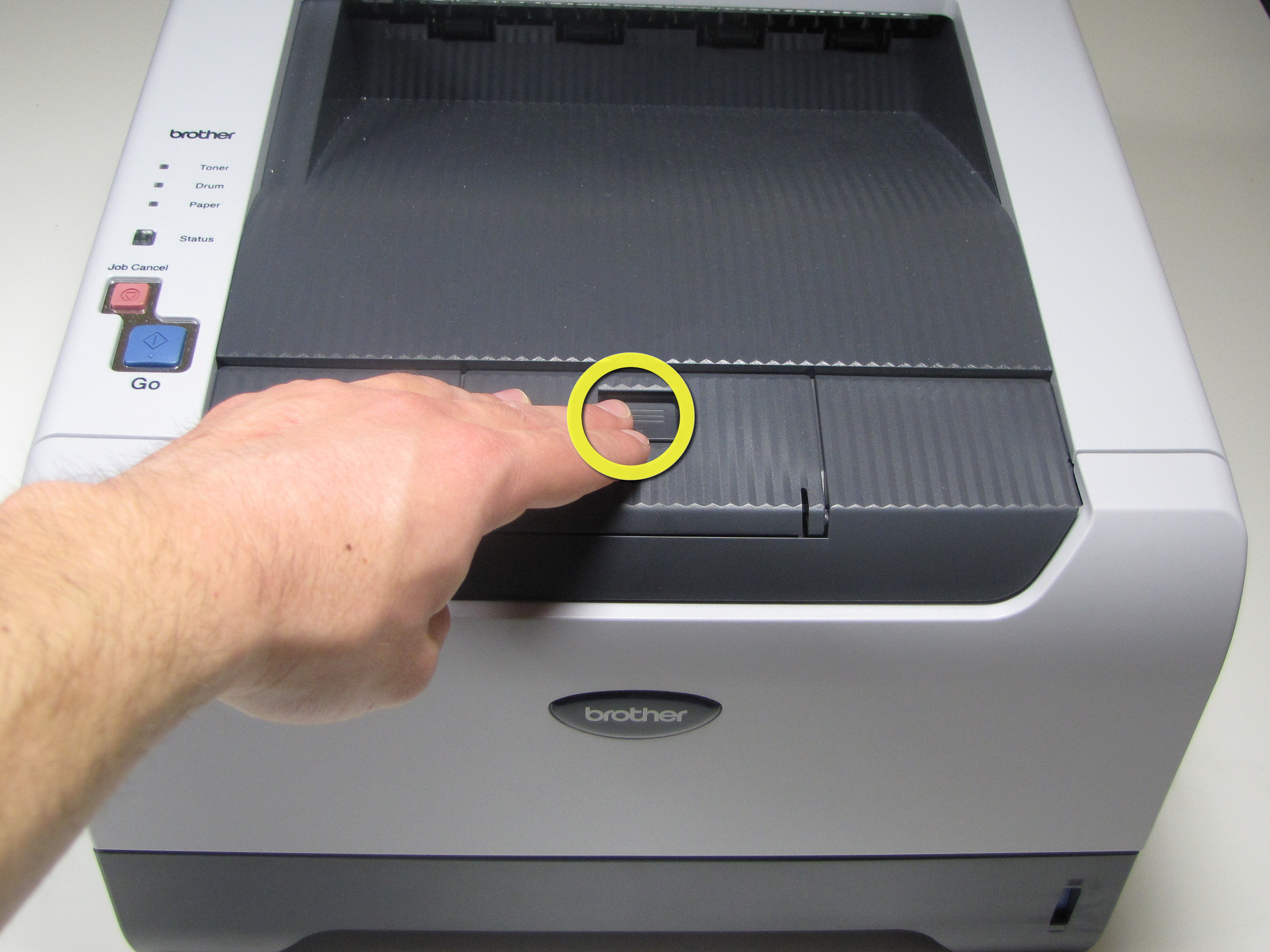

This guide tells you how to remove the drum & toner unit from the printer before you perform any maintenance.
Image #1
Add Note Edit Step 1 — Drum Unit and Toner Cartridge  ¶
  • Press the front cover release button.
  • Keep the button pressed and pull the cover toward yourself.
Image #1 Image #2 Image #3
Add Note Edit Step 2  ¶
  • With the front cover in the downward position, the drum & toner unit will be visible.
  • Grab the black-and-yellow handle on the unit. Lift unit up and pull it out of the printer.
