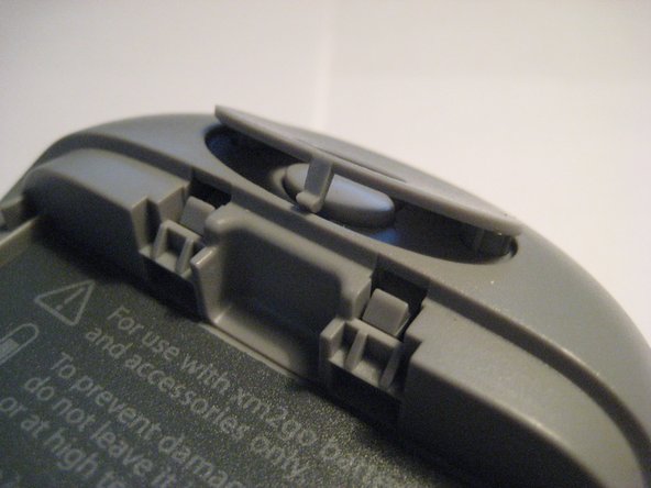

Add Note Edit Step 9  ¶
  • With the cover lifted up and removed, there are two holes where the T6 screwdriver can fit into and remove the screws.
  • NOTE: Be sure to keep track of the cover and not lose it.

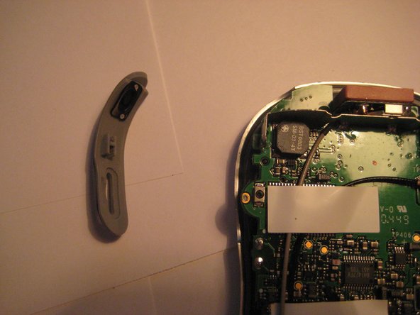

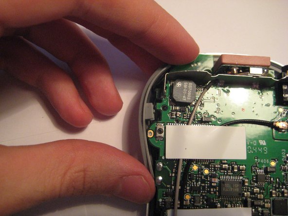

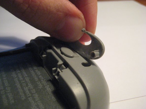

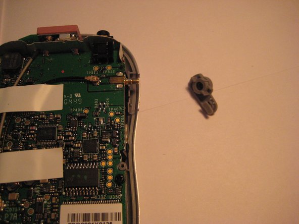

Image #1 Image #2 Image #3
Add Note Edit Step 11  ¶
  • Remove the power button from the left.
  • Locate the antenna extension connector on the right and remove the plastic piece.

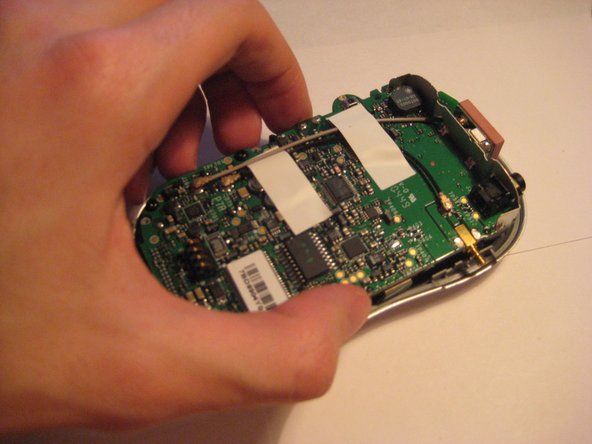

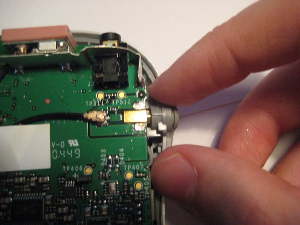

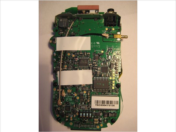

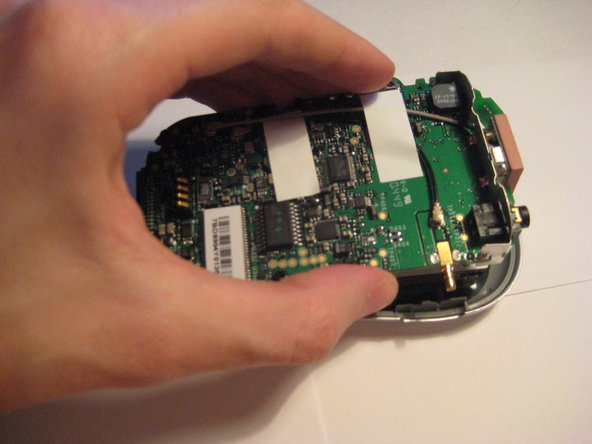

Add Note Edit Step 12  ¶
  • With the screws and the two external pieces removed, the PCB Logic Board can be removed from the front piece.
  • Simply pull up on the PCB Logic Board to remove.
  • CAUTION: Be careful of the LCD screen and keypad as they are only connected via ribbon cables to the board. They will hang down as the PCB Logic Board is removed.

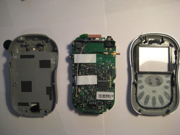

Image #1
Add Note Edit Step 13  ¶
  • The front plate, back plate, and PCB Logic Board (motherboard) are then free from the device.

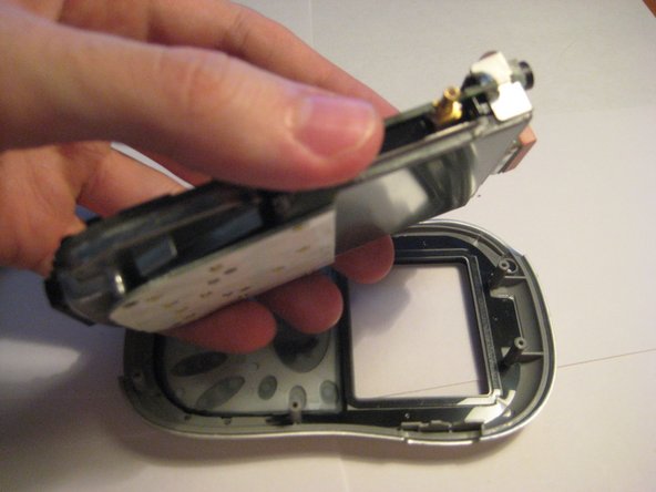

Image #1 Image #2
Add Note Edit Step 14 — Removing Delphi Myfi XM2GO LCD Screen  ¶
  • The logic board must be exposed to begin.
  • Flip the device over (see second picture).
  • CAUTION: The keyboard is loosely attached by a ribbon cable and may move when the device is flipped.

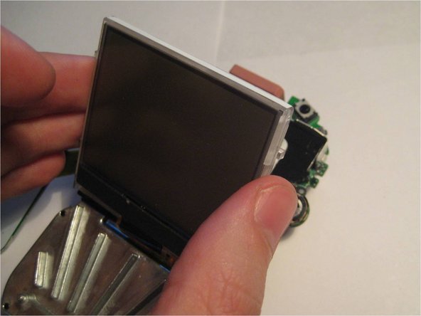

Image #1
Add Note Edit Step 15  ¶
  • Lift up the keyboard carefully from the right side, flipping to the left.
  • NOTE: The keyboard is attached on the left side by a ribbon cable. Do not remove it completely yet.

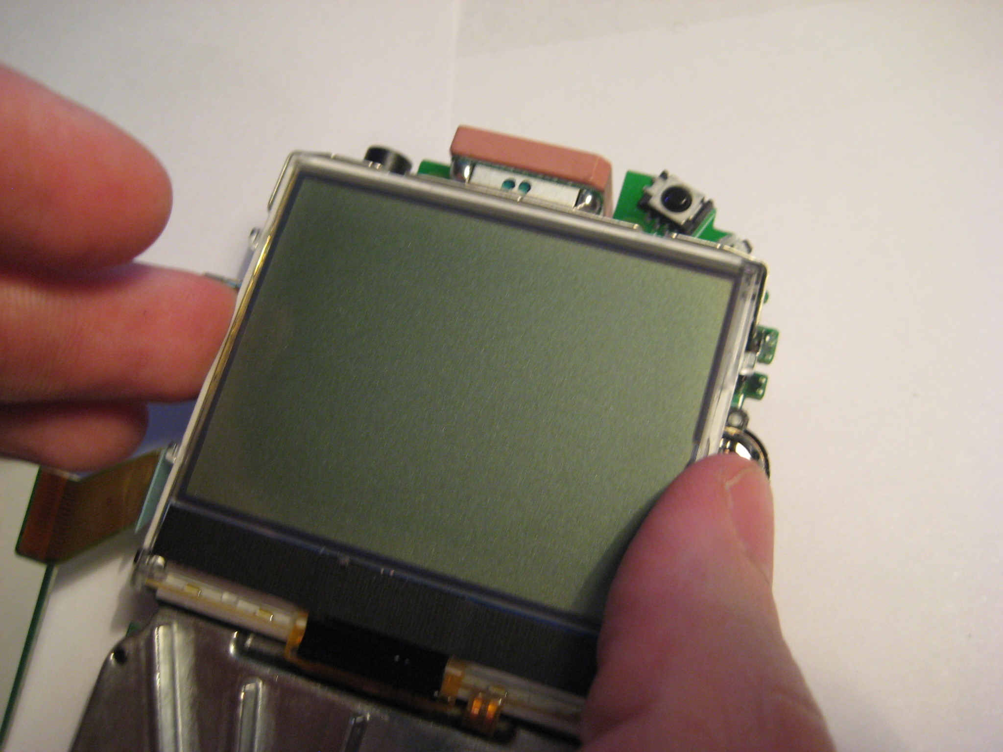

Add Note Edit Step 16  ¶
  • Pivot the LCD screen, pulling on the top and sides and keeping the bottom attached.
