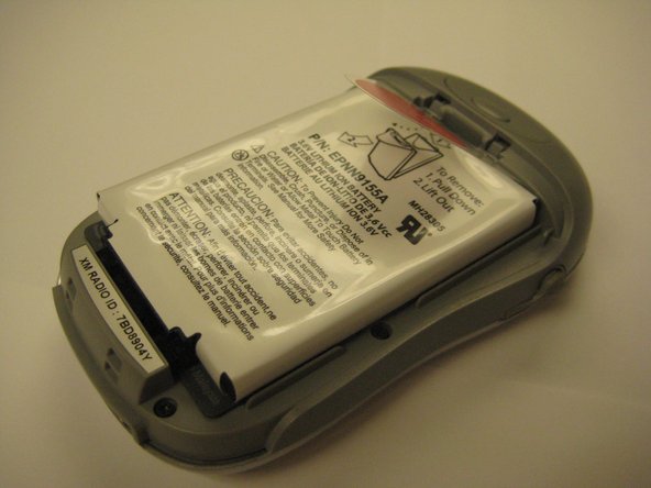

Add Note Edit Step 3  ¶
  • After the cover is removed, the white Lithium Ion battery is visible.

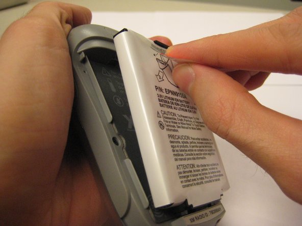

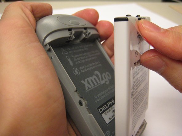

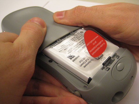

  • The battery comes from the manufacturer with a pull tab with a web address printed on it to direct the user in purchasing a new battery.
  • Holding the device, grab the tab with thumb and index figure.
Image #1 Image #2 Image #3
Add Note Edit Step 5  ¶
  • Pull down on the tab so that the battery block moves a few millimeters towards the bottom of the device.
  • The battery will move parallel to the back of the device while a latch at the top is freed with the downward motion.
  • There is a pivot point at the bottom of the battery where the contacts connect to the battery.
  • After the latch at the top is disengaged, pivot the battery away from the back and the battery will be free.

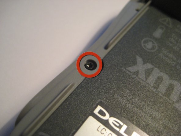

  • To start the takedown process, locate the four hex screws on the bottom of the device.
  • Use a T6 hex bit, perhaps from the iFixit precision screwdriver set, to remove the four screws.

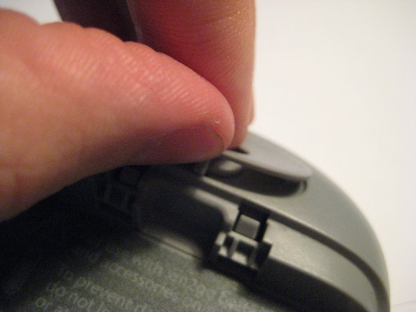

Add Note Edit Step 8  ¶
  • To remove the next two T6 screws, locate the button at the top of the back of the device.
  • Around the button, there is a cover that protects the two screws. This cover is accessible by inserting a thumbnail into the bottom and pulling up.
