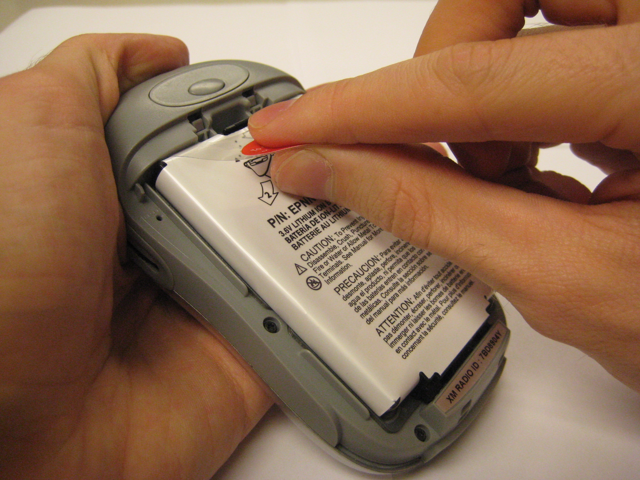

  • After the cover is removed, the white Lithium Ion battery is visible.
Image #1
Add Note Edit Step 4 — Removing Delphi MyFi XM2GO Battery  ¶
  • Removing the back cover allows access to the user-removable battery.
  • Should the battery need to be replaced or swapped, following these steps will aid in the process.
  • The battery comes from the manufacturer with a pull tab with a web address printed on it to direct the user in purchasing a new battery.
  • Holding the device, grab the tab with thumb and index figure.
Image #1 Image #2 Image #3
Add Note Edit Step 5  ¶
  • Pull down on the tab so that the battery block moves a few millimeters towards the bottom of the device.
  • The battery will move parallel to the back of the device while a latch at the top is freed with the downward motion.
  • There is a pivot point at the bottom of the battery where the contacts connect to the battery.
  • After the latch at the top is disengaged, pivot the battery away from the back and the battery will be free.
Image #1
