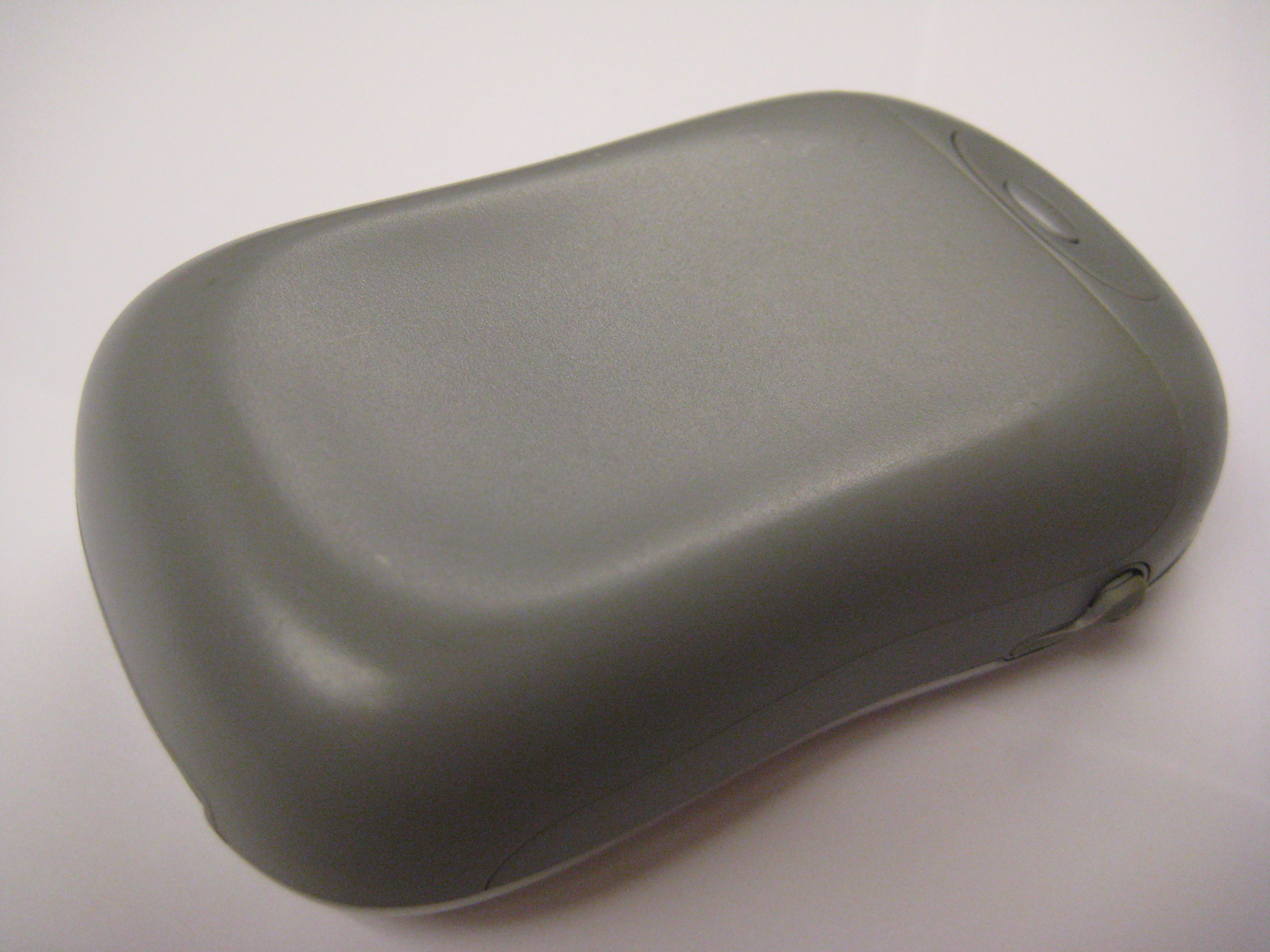

This guide demonstrates the removal of the battery cover which is necessary for working on the internals of the device.
  • Author: Scott Byer
  • Time required: 1 Minute
  • Difficulty: Very easy
Image #1
Add Note Edit Step 1 — Removing Delphi MyFi XM2GO Battery Cover  ¶
  • Flip the Delphi MyFi XM2GO Device on its back to start the cover-removal process.
  • The back cover is the access point for the user-removable battery. Removing the back cover also gives the user access to the hard-reset button.
Image #1 Image #2 Image #3
Add Note Edit Step 2  ¶
  • Locate the large button on the top back of the device. This button is used to release the latch holding the sliding back cover in place.
  • Press this button at the top while making a firm grip on the battery cover.
  • As the button is pressed, move the cover towards the bottom of the device while applying moderate pressure to the cover.
  • Be careful to not press down too hard on the battery cover as it is made of plastic.
  • The battery removal tab may pop up during the cover removal process.
Image #1
Add Note Edit Step 3  ¶
  • After the cover is removed, the white Lithium Ion battery is visible.
