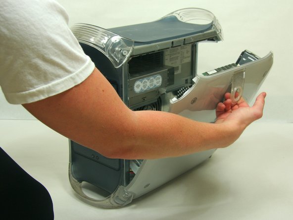

Add Note Edit Step 1 — Case  ¶

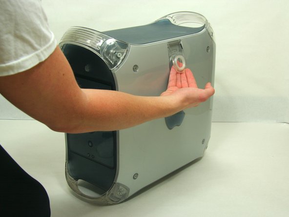

  • Pull on outer latch.
  • Lower door until it is level with your work surface.
  • Before working on the computer make sure it is not plugged into a power supply, then touch a metal object. This discharges static electricity, which could damage the computer.

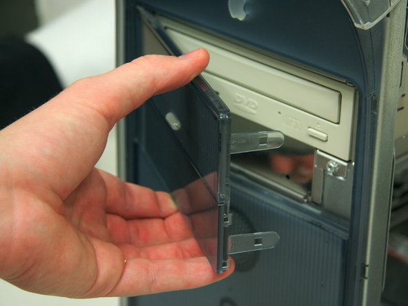

  • Removing the faceplate.
    • On the inside of the case, find the two plastic tabs.
    • While depressing the tabs, remove the faceplate by pulling and rotating outward.

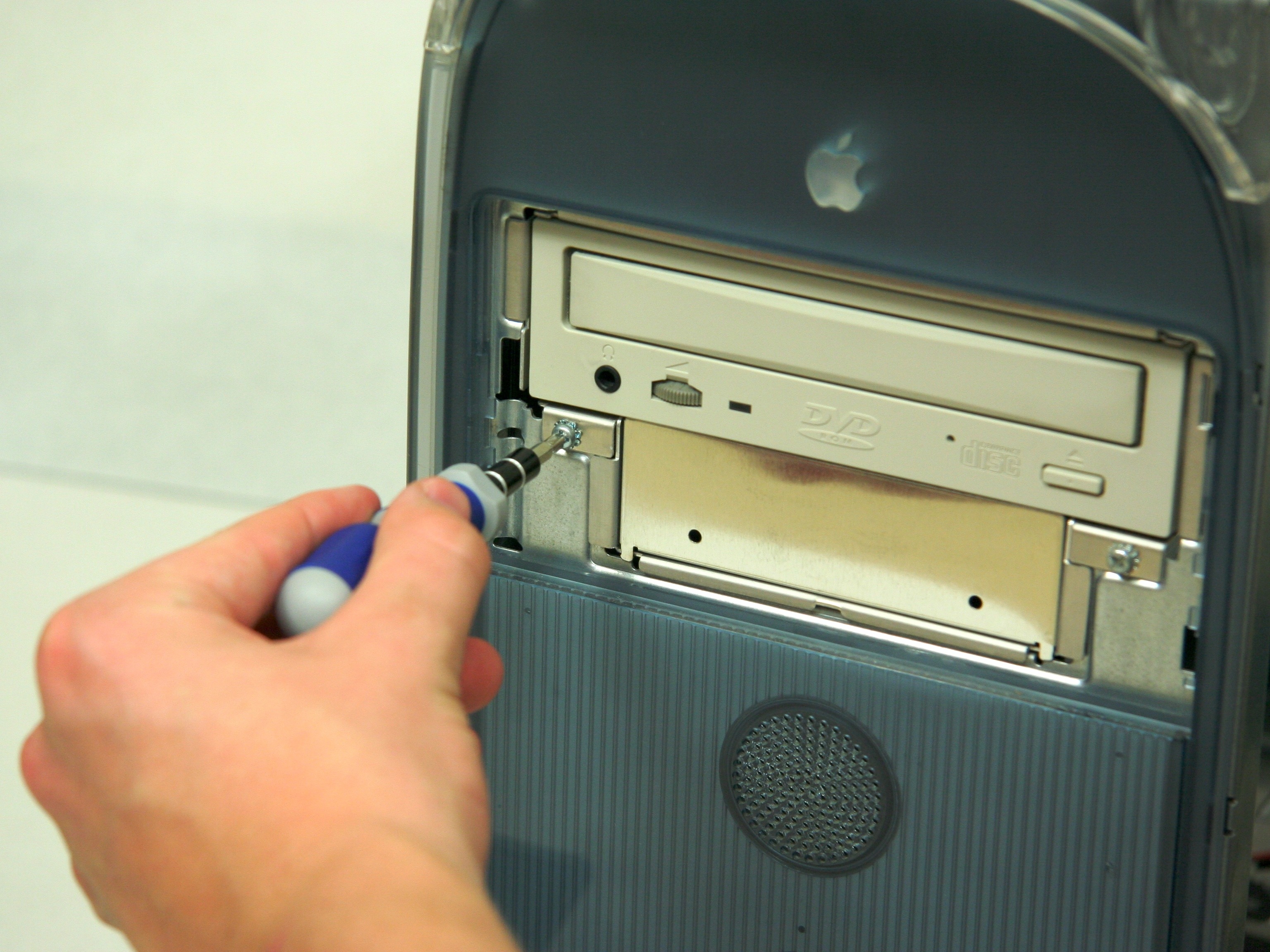

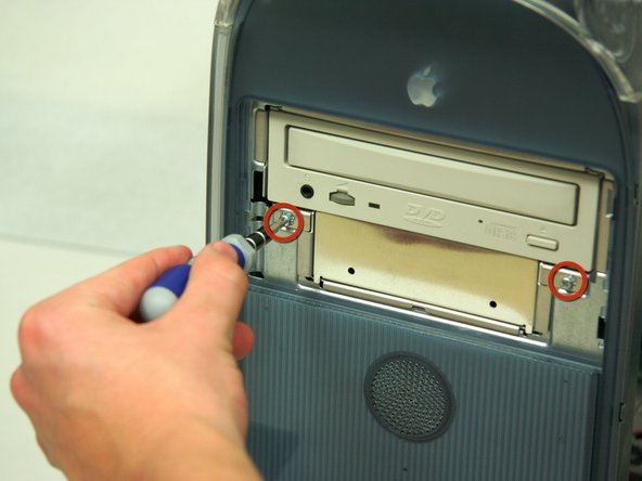

Add Note Edit Step 3  ¶

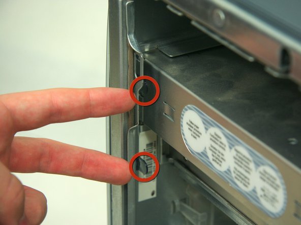

  • Remove the two screws on the front of the drive with the Phillips #1 screwdriver.
Image #1 Image #2 Image #3
Add Note Edit Step 4  ¶

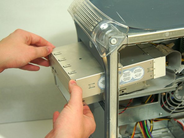

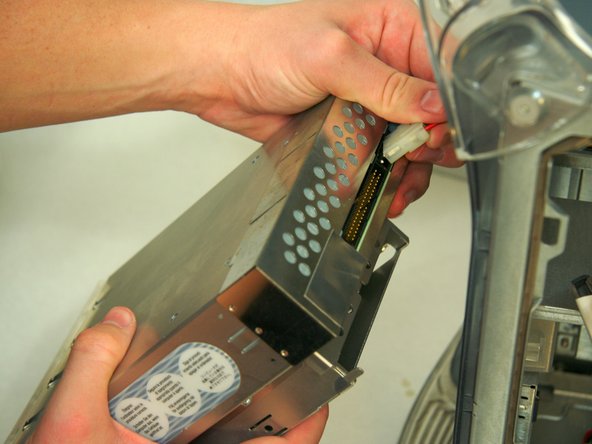

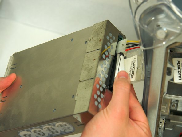

  • Pull the drive out to allow access to the power and ribbon cables. Do not fully remove.
  • Remove both the power and ribbon cable.
