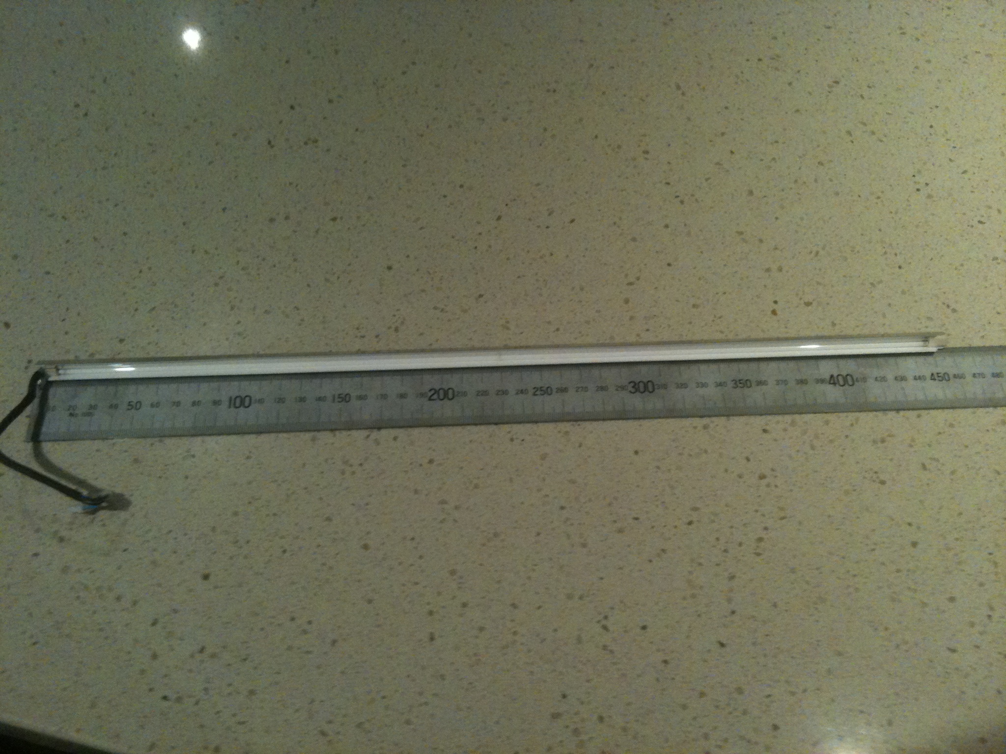

This guide will show you how to remove the CCFL tubes from the CCFL assembly.
Tools (continued)
Relevant Parts
  • CCFL - 446mm x 2.4mm (4) , QTY There are 4 CCFL in the LCD assembly, 2 top and 2 bottom. You may not need to replace all but if going to the trouble of replacing 1, suggest you do all 4 Buy it
