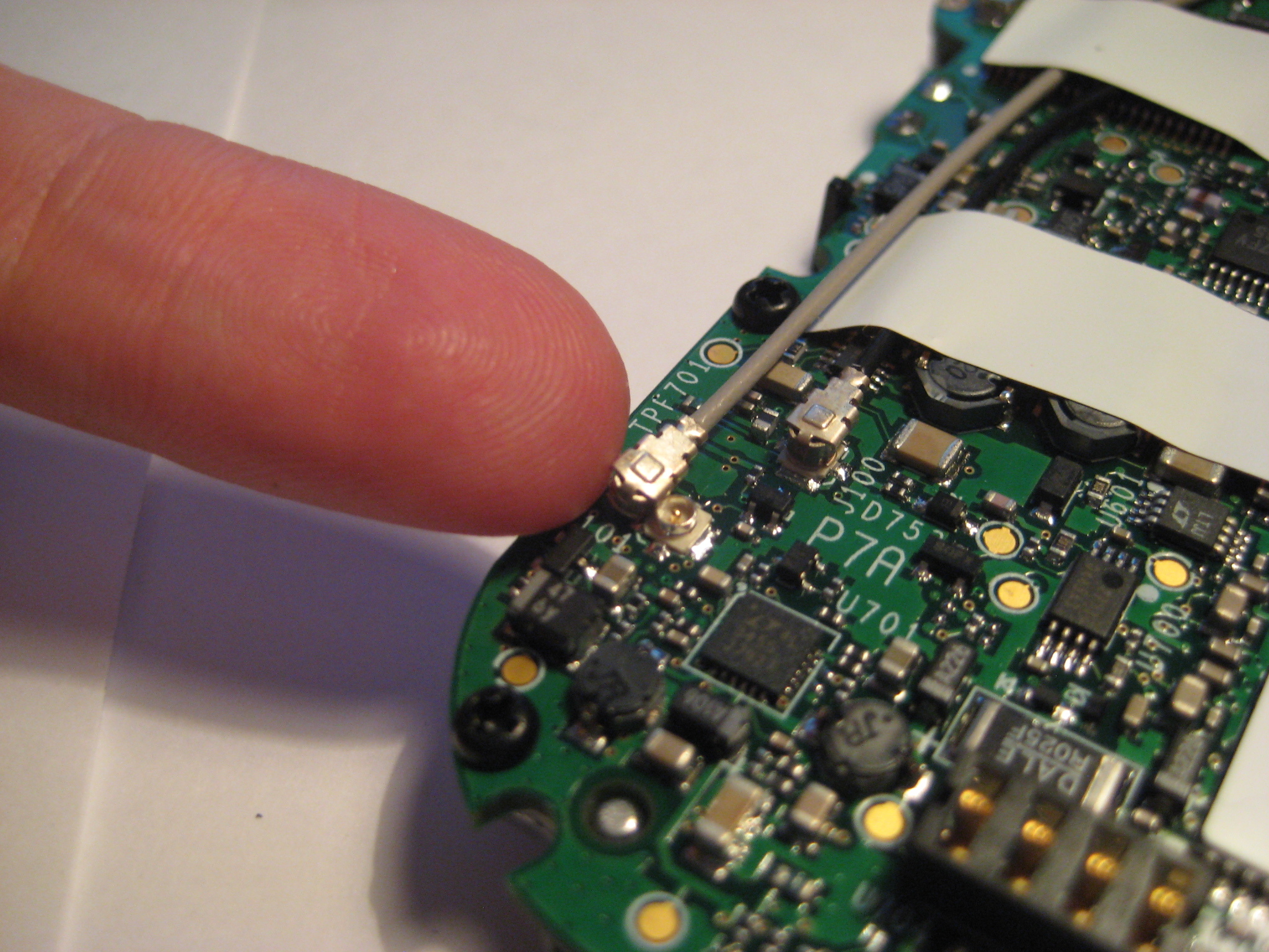

This guide details an internal antenna connector check for the U.FL connectors on the Delphi XM2GO.

Add Note Edit Step 6  ¶
  • With the battery removed, the back of the device reveals more information about the product.
Image #1 Image #2 Image #3
Add Note Edit Step 7 — Removing Delphi MyFi XM2GO Logic Board  ¶
  • To start the takedown process, locate the four hex screws on the bottom of the device.
  • Use a T6 hex bit, perhaps from the iFixit precision screwdriver set, to remove the four screws.
Add Note Edit Step 8  ¶
  • To remove the next two T6 screws, locate the button at the top of the back of the device.
  • Around the button, there is a cover that protects the two screws. This cover is accessible by inserting a thumbnail into the bottom and pulling up.
