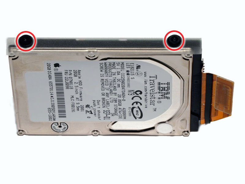

Add Note Edit Step 5 — Hard Drive  ¶
  • Disconnect the hard drive ribbon from the logic board using a spudger or the tip of your finger, removing tape as necessary.
Image #1
Add Note Edit Step 6  ¶
  • To free the hard drive, remove the two T8 Torx screws from the right wall of the battery housing.
Image #1
Add Note Edit Step 7  ¶
  • Remove the hard drive by gently grasping the orange ribbon cable and lifting the left edge up and out of the computer.
  • There are four rubber bumpers that fit over the hard drive screws. Ensure that these bumpers come out when you remove the hard drive.
Image #1
Add Note Edit Step 8  ¶
  • Your laptop should look approximately like this.
