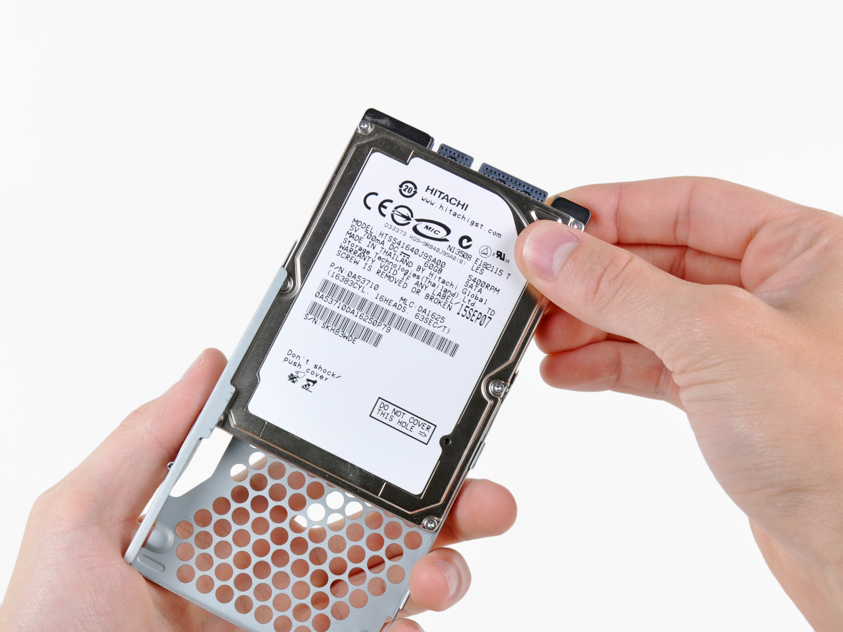

    • Remove the four 4.3 mm Phillips screws securing the hard drive cage to the hard drive.
    • These 4 screws can sometimes be very difficult to remove. If you strip the heads our Screw Extracting Pliers remove the damaged screws nicely.
  6. PlayStation 3 Hard Drive Replacement: step 6, image 1 of 1
    • Remove the hard drive from its steel cage.
    • If you're installing a new hard drive into your PS3, use this guide to restore the data you backed up.
