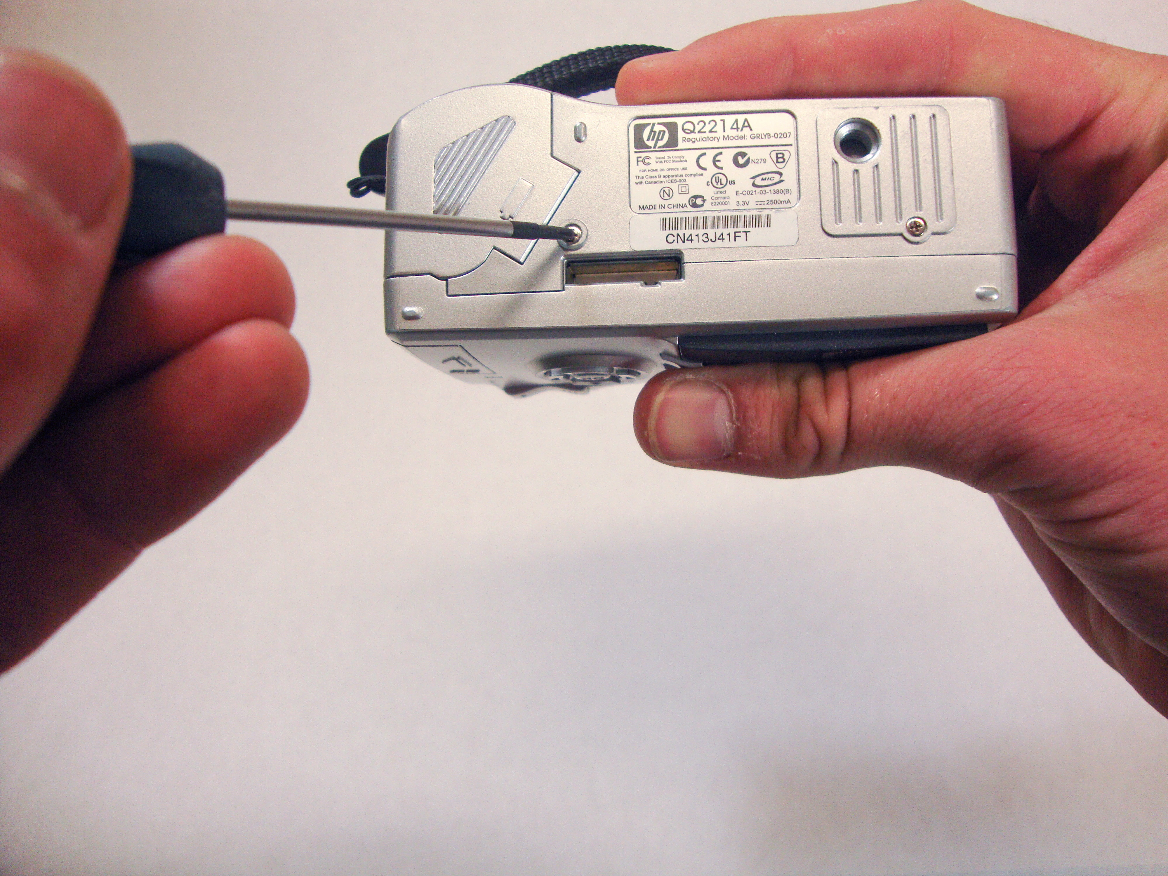

Add Note Edit Step 4 — Plastic Casing  ¶
  • Unless otherwise stated, use a phillips #00 screwdriver to remove screws.
  • Remove the two 4.70mm screws in the bottom of the plastic casing.
Image #1 Image #2
