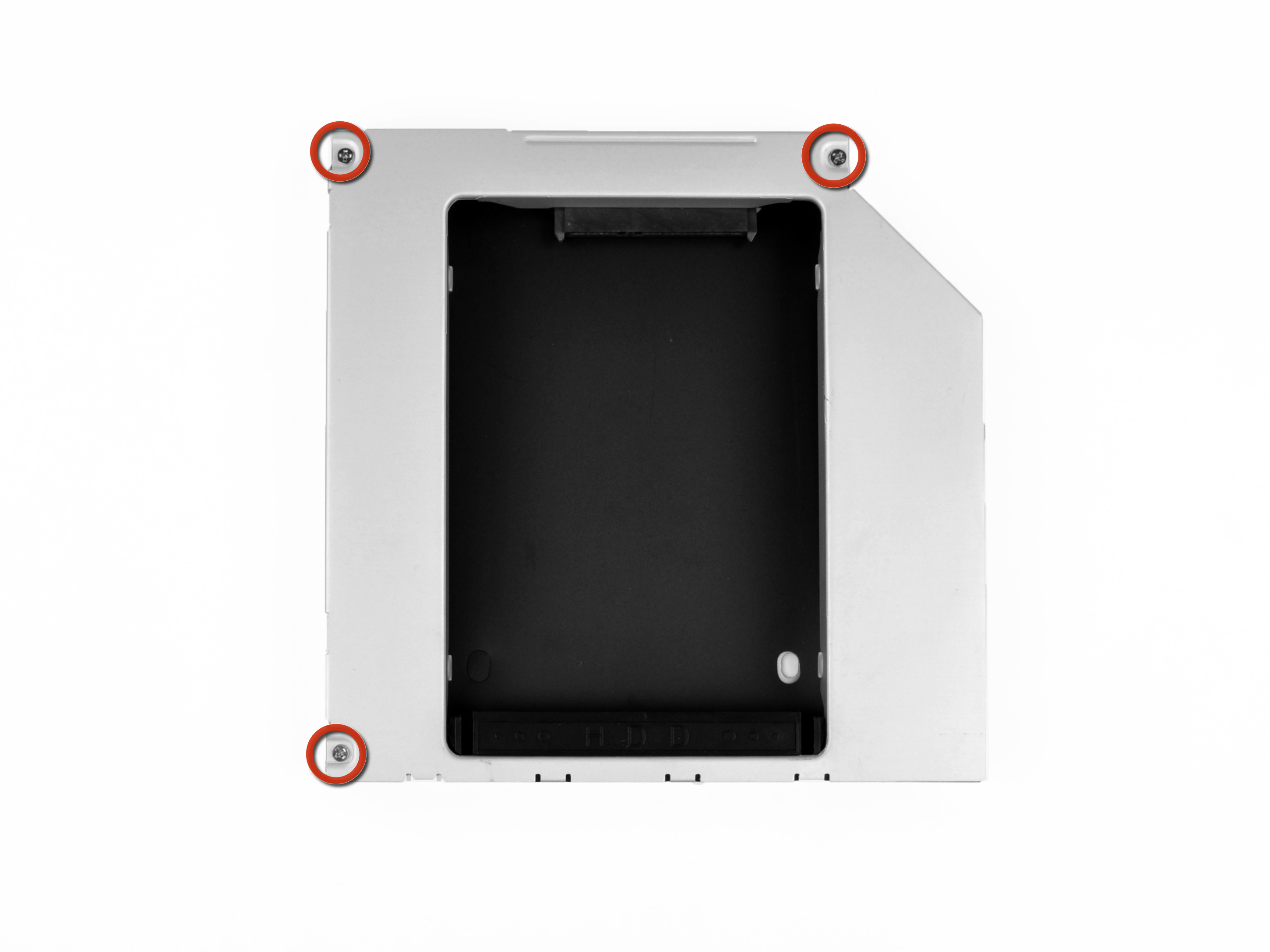

Add Note Edit Step 1 — Optical Drive Enclosure Faceplate  ¶
  • Remove the three 3.0 mm Phillips #0 screws from the optical bay enclosure.
Image #1 Image #2 Image #3
Add Note Edit Step 2  ¶
  • Starting from the left edge, gently pull open the optical bay enclosure.
  • Continue to pull open the two halves of the enclosure until they separate.
Image #1
Add Note Edit Step 3  ¶
  • Remove the two 3.0 mm Phillips #0 screws securing the faceplate to the optical bay enclosure.
Add Note Edit Step 4  ¶
  • Lift the black plastic faceplate out of the optical bay enclosure.
    • You will no longer need the faceplate or the two Phillips screws that held it in place. Set those parts aside if you ever wish to put the faceplate back into the enclosure.
  • Reassemble the optical bay enclosure without the faceplate, reusing the original three 3.0 mm Phillips screws to keep it intact.
