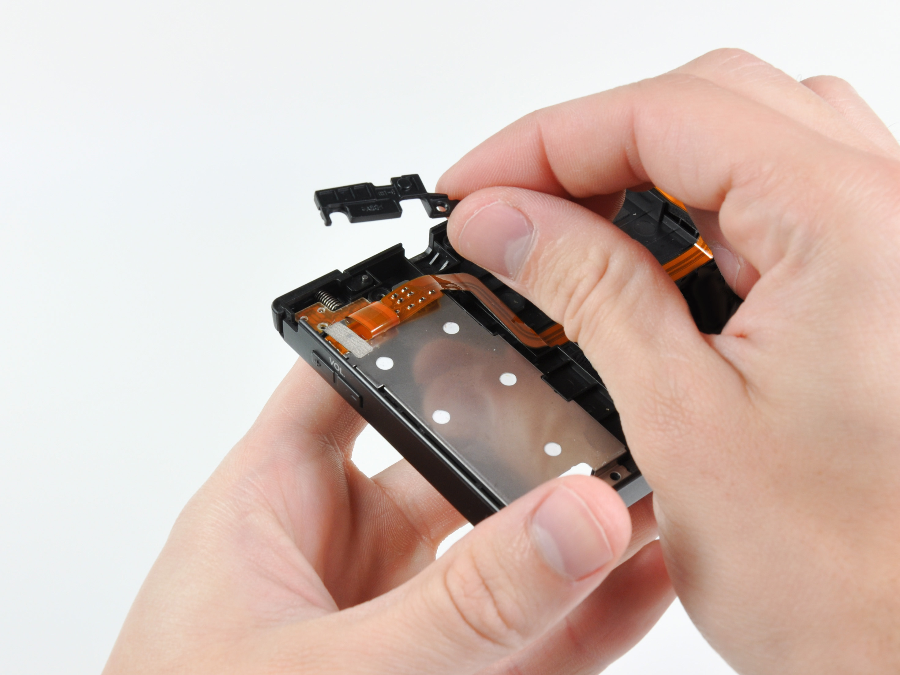

Add Note Edit Step 7 — Stylus Housing  ¶
  • Pull the stylus straight out its housing and remove it from the rear case.
Image #1
Add Note Edit Step 8  ¶
  • Remove the five 3.9 mm Phillips screws securing the stylus holder to the rear case.
