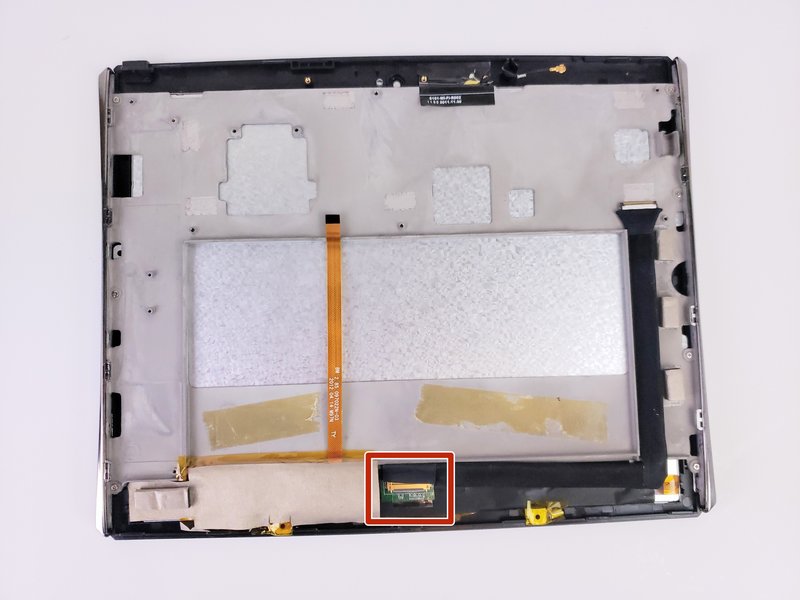

  15. Matsunichi M97 9 inch Screen Replacement, Screen: step 15, image 1 of 3 Matsunichi M97 9 inch Screen Replacement, Screen: step 15, image 2 of 3 Matsunichi M97 9 inch Screen Replacement, Screen: step 15, image 3 of 3
    • Peel off the black and the clear tape covering the display cable connection.
    • Pull the display cable to disconnect it from the display.
