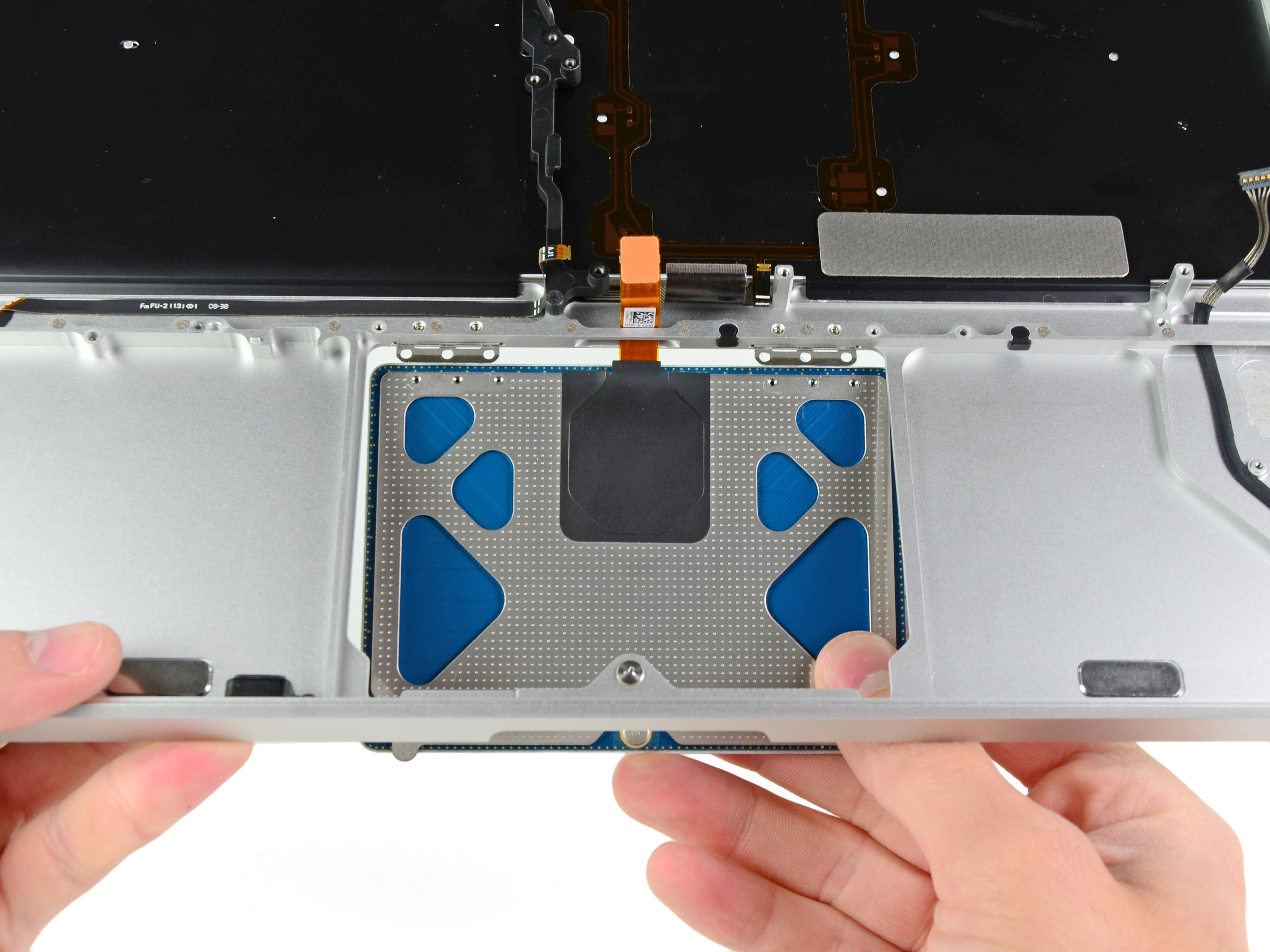

Image #1 Image #2 Image #3
Add Note Edit Step 14  ¶
  • Grab the upper case with your right hand and rotate it slightly toward the top of the display so the upper display bracket clears the edge of the upper case.
  • Rotate the display slightly away from the upper case.
  • Lift the display away from the upper case, minding any brackets or cables that may get caught.

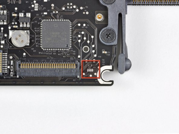

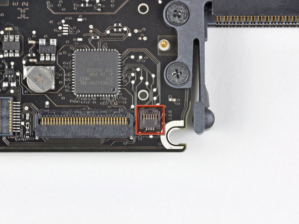

Image #1 Image #2
Add Note Edit Step 15 — Upper Case  ¶
  • Some 2.0 GHz A1278 MacBook Unibody logic boards do not have the necessary socket installed to accept the keyboard backlight ribbon cable attached to the upper case. The first and second pictures show logic boards with and without the socket installed, respectively. If your logic board does not have the backlight ribbon cable socket installed, the keyboard will work but the keys will not light up.
  • If your logic board does not have the socket installed to accept the keyboard backlight ribbon cable and you are installing a backlit upper case, simply tuck the keyboard backlight ribbon cable out of the way when you reinstall the logic board into the upper case.

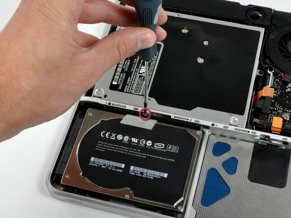

Image #1
Add Note Edit Step 16  ¶
  • Remove the single Phillips screw securing the hard drive bracket to the chassis.
  • This screw is captive to the hard drive bracket.
