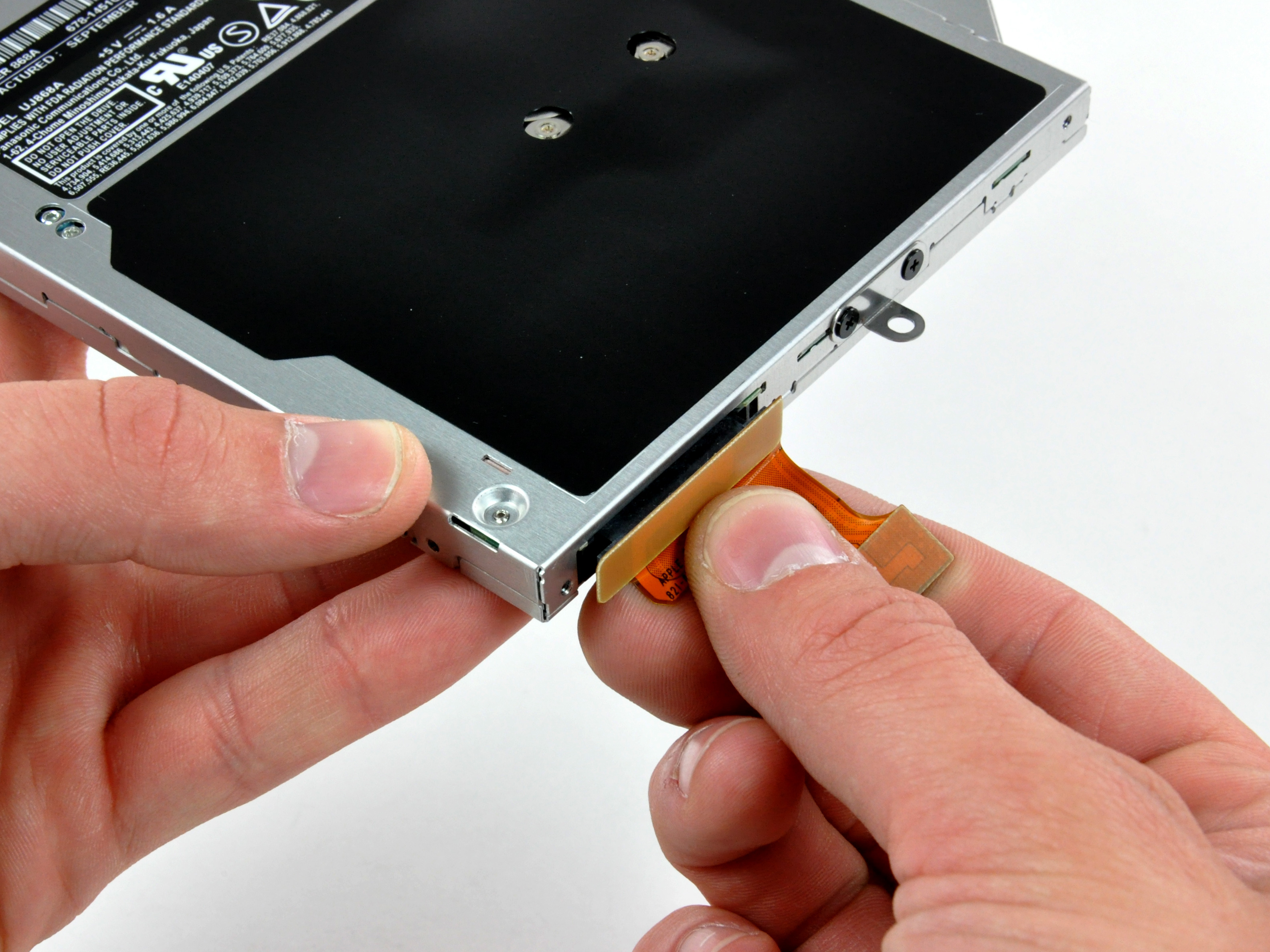

  14. MacBook Unibody Model A1278 Optical Drive Replacement, Optical Drive: step 14, image 1 of 1
    • Remove the optical drive cable by pulling it straight away from the optical drive.
    • This connector is particularly deep, so be sure to pull away from the drive at the center of the connector.
    • If you have a CD or any other object jammed in your optical drive, we have an optical drive repair guide.
