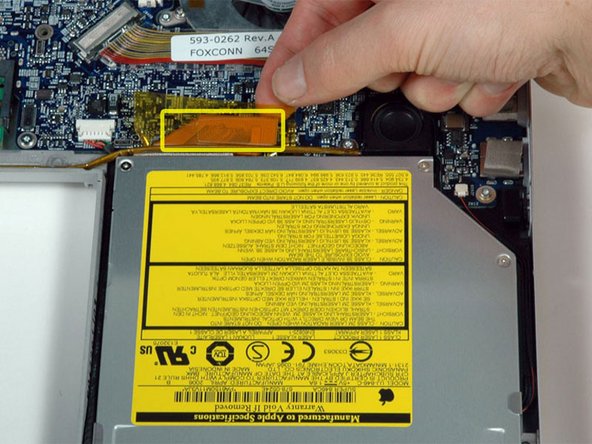

Add Note Edit Step 11 — Optical Drive  ¶
  • Disconnect the orange SuperDrive ribbon cable from the logic board, removing tape as necessary.

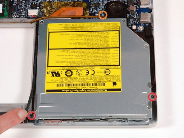

Add Note Edit Step 12  ¶
  • Remove the following three screws:
    • Two black 4 mm T6 Torx screws on either side of the SuperDrive.
    • One 8.7 mm silver (black in some models) T6 Torx screw at the back of the drive near the speaker.

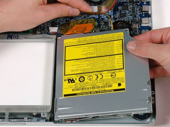

Image #1
Add Note Edit Step 13  ¶
  • Use one hand to pull back the speaker cable and use your other hand to lift the optical drive up and out of the computer.

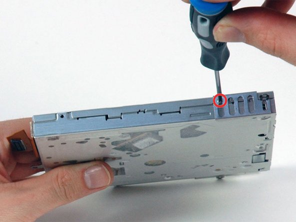

Add Note Edit Step 14 — Optical Drive Replacement  ¶
  • Remove the single Phillips screw securing the mounting bracket to the left side of the optical drive.

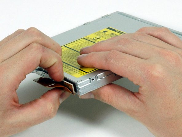

Add Note Edit Step 15  ¶
  • Rotate the drive and disconnect the orange ribbon cable from the optical drive.

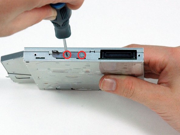

Add Note Edit Step 16  ¶
  • Remove the two Phillips screws securing the mounting bracket to the rear of the optical drive.
