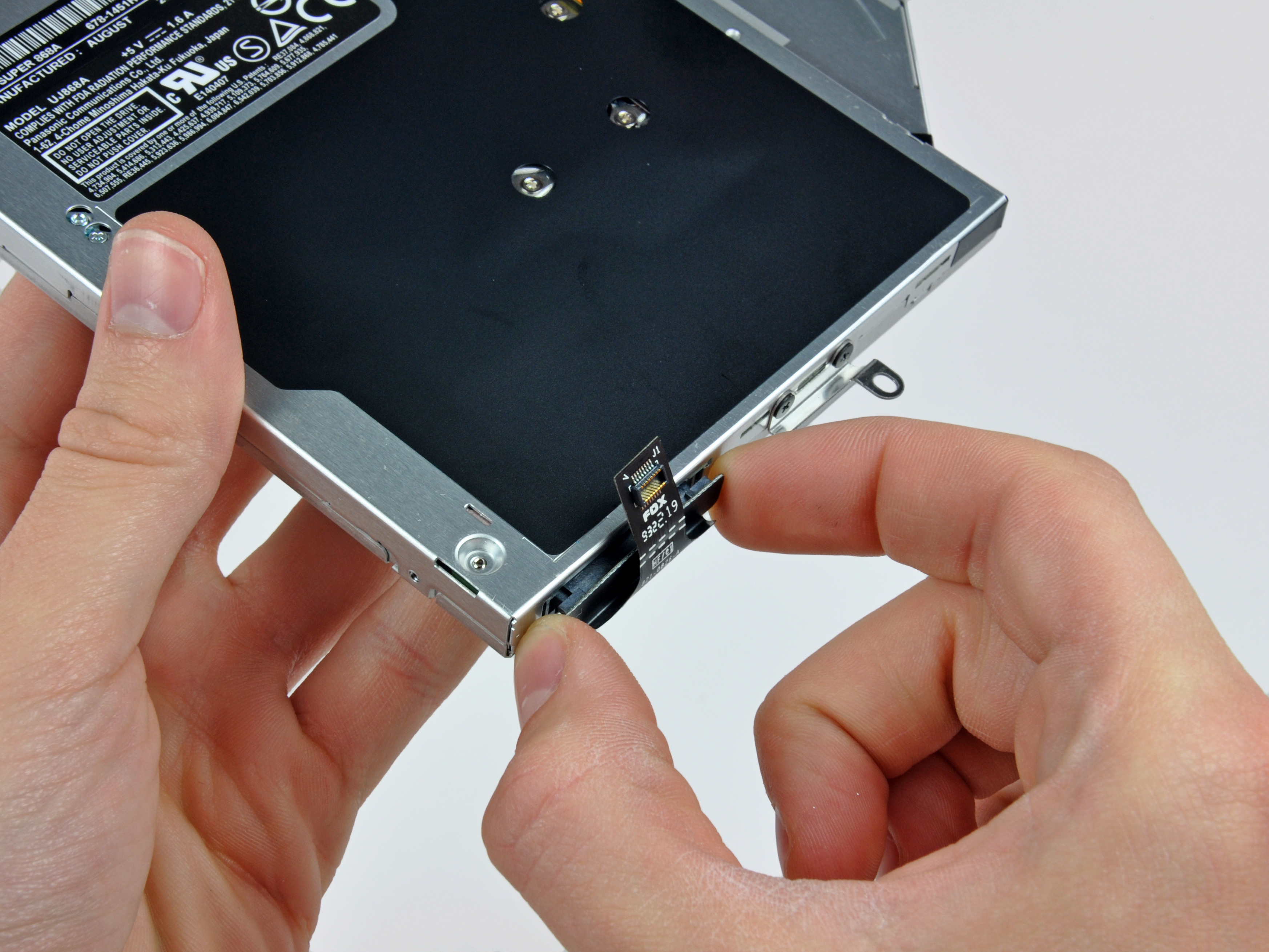

Add Note Edit Step 13 — Optical Drive Replacement  ¶
  • Pull the optical drive cable out of the optical drive.
  • Be sure to pull by the edges of the connector, not by the cable itself.
  • Optical drive remains.
  • If you have a CD or any other object jammed in your optical drive, we have an optical drive repair guide.
