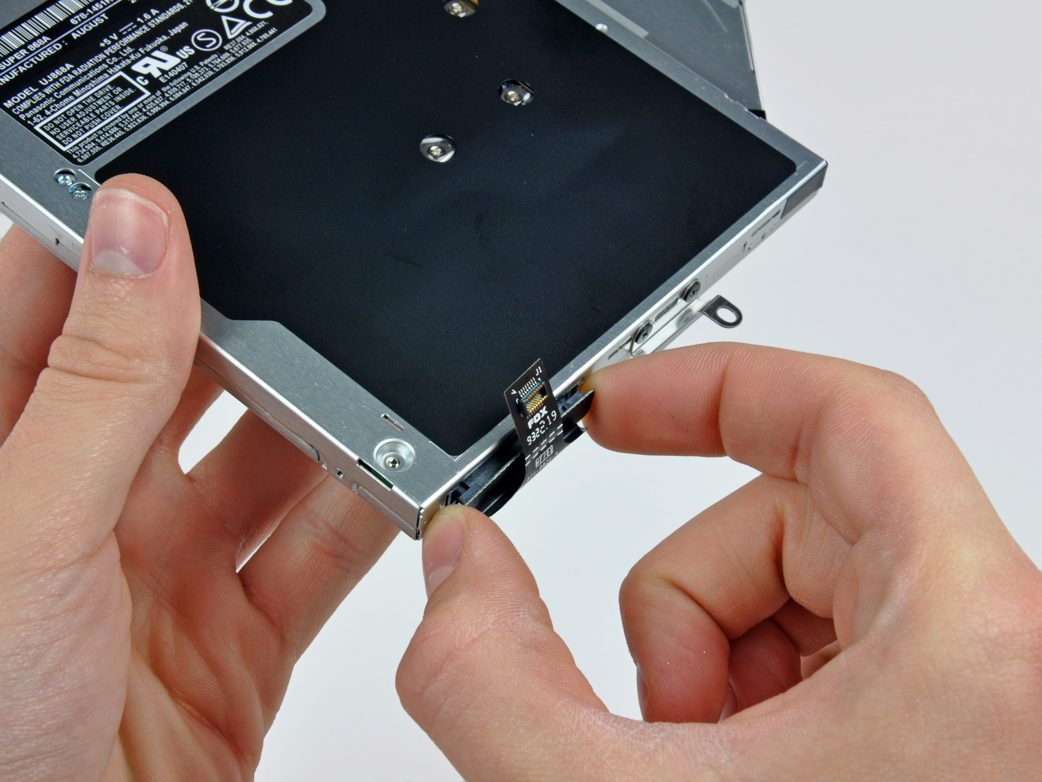

  16. MacBook Pro 15" Unibody Mid 2009 Optical Drive Replacement, Optical Drive: step 16, image 1 of 1
    • Remove the optical drive cable by pulling it straight away from the optical drive.
    • If you have a CD or any other object jammed in your optical drive, we have an optical drive repair guide.
