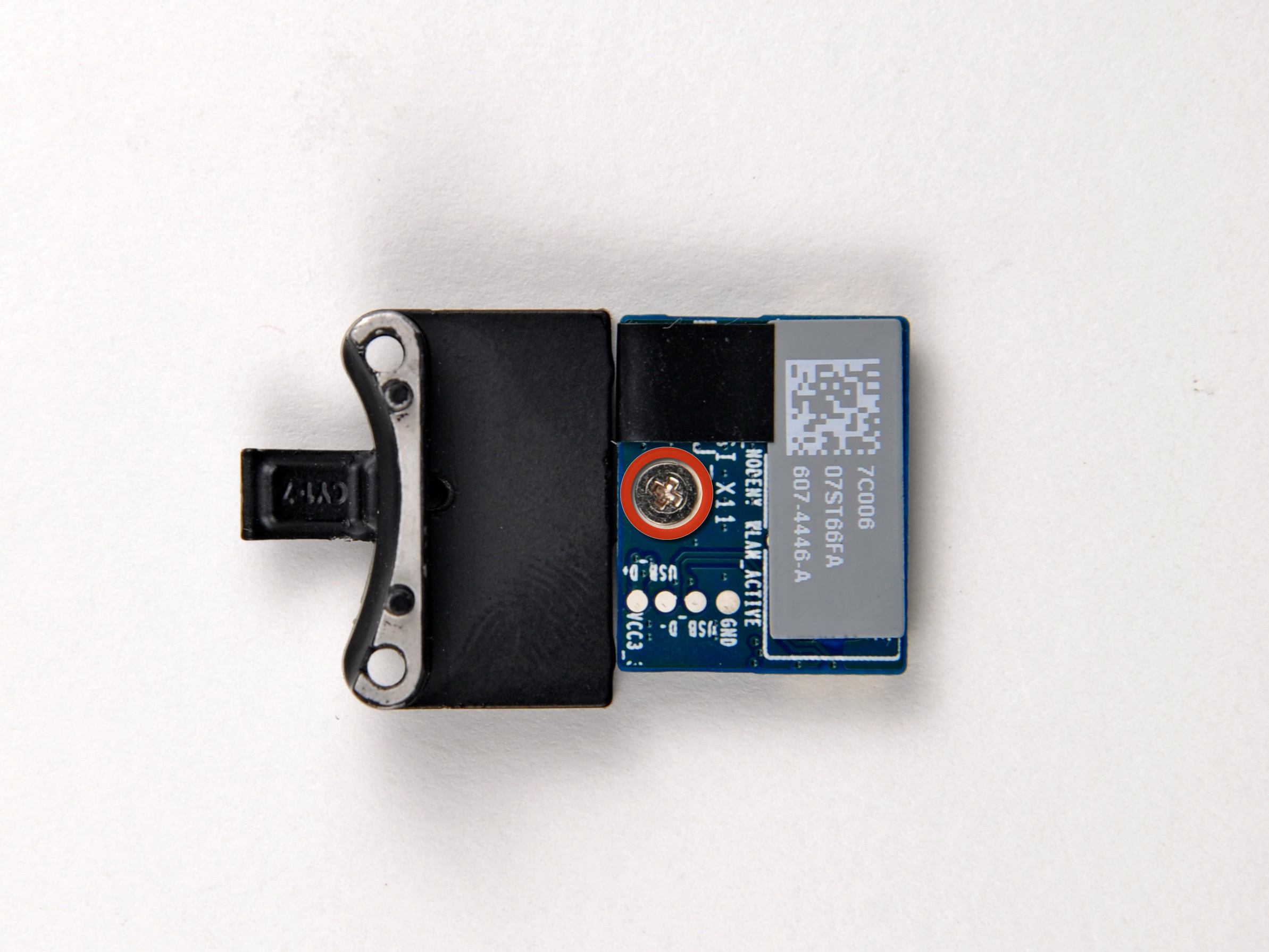

Add Note Edit Step 5 — Bluetooth Board Replacement (Anti-Glare Option)  ¶
  • Remove the single Phillips screw securing the Bluetooth board to the retainer.
  • Lift the Bluetooth board off the retainer.
