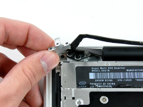

  • Remove two 8 mm Phillips screws securing the camera cable bracket to the upper case.
  • The rightmost screw may remain captive in the camera cable.
  • Lift the camera cable bracket out from the upper case.

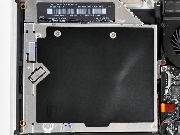

  • Remove the following three Phillips screws securing the optical drive to the upper case:
    • One 3.5 mm Phillips screw.
    • Two 2.5 mm Phillips screws.

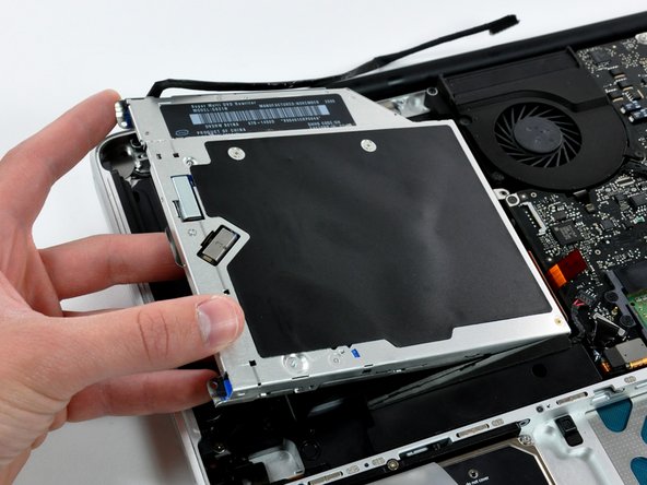

Add Note Edit Step 11  ¶
  • Lift the optical drive from its left edge and pull it out of the computer.
Image #1

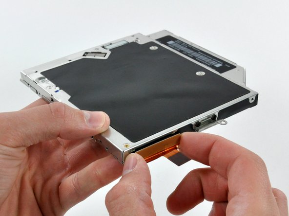

Add Note Edit Step 12 — Optical Drive Replacement  ¶
  • Remove the optical drive cable by pulling it straight away from the optical drive.
  • If you have a CD or any other object jammed in your optical drive, we have an optical drive repair guide.
Image #1

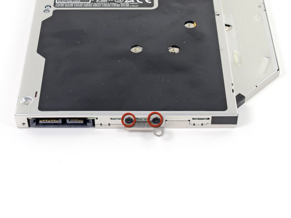

Add Note Edit Step 13  ¶
  • Remove the two black Phillips #0 screws securing the small metal mounting bracket. Transfer this bracket to your new optical drive or hard drive enclosure.
