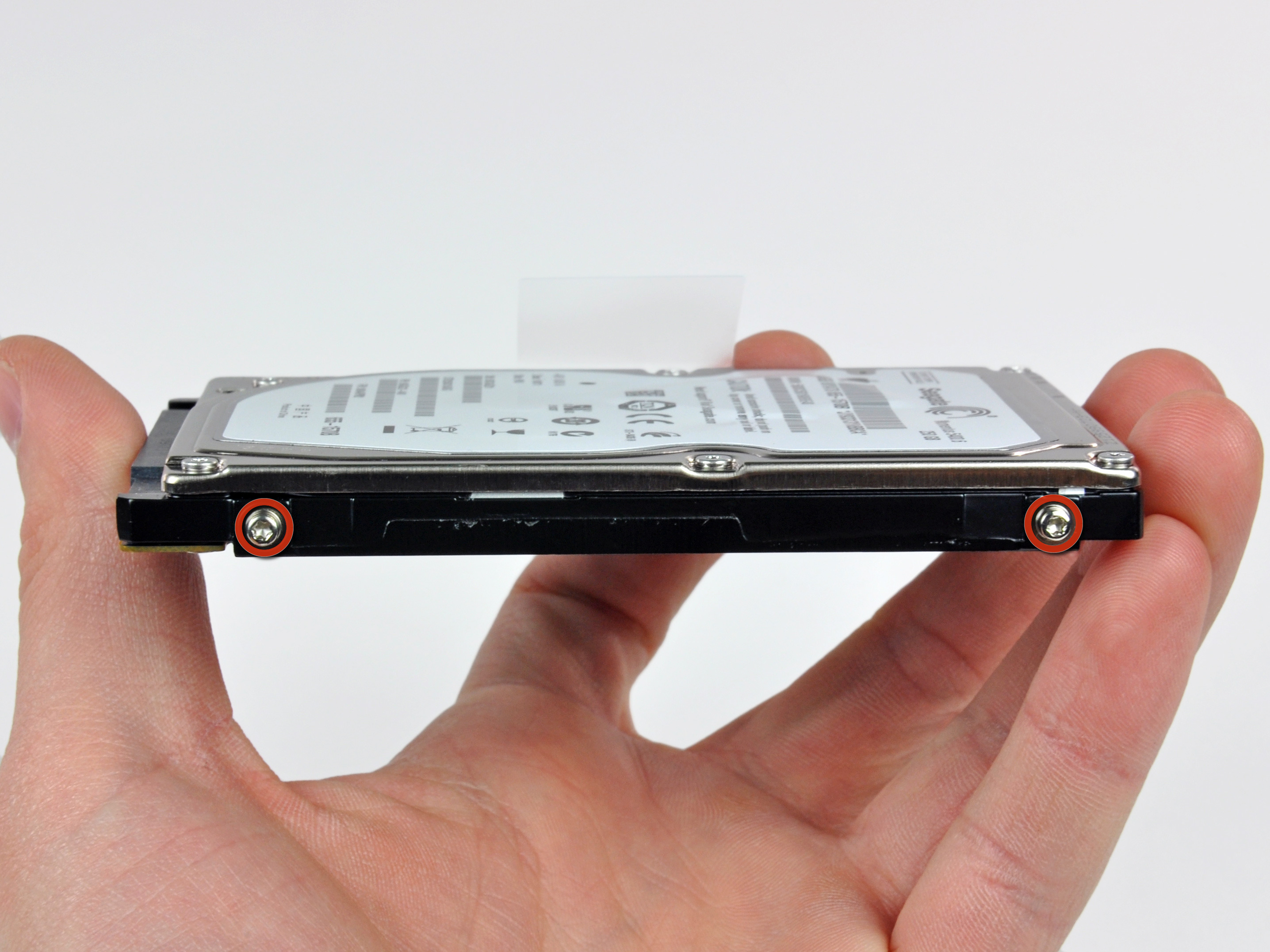

    • Seven 3 mm Phillips screws.
first image
Add Note Edit Step 2  ¶
  • Using both hands, lift the lower case near the vent to pop it off two clips securing it to the upper case.
first image
  • Three special five-point Torx screws secure the battery to the upper case. They can be removed with this special driver.
  • If you don't have the special 5-point tool, a common 1.5 mm flathead screwdriver can be used in a pinch. Be sure the head of your flathead screwdriver fits snugly across two of the five "points" of the screw head before trying to break the screw free, as a loose fit will easily strip the screw head. If the head of your screwdriver fits too loosely, find a bigger bit and file it down until it fits snugly before proceeding.
  • You do not necessarily have to follow steps 3-7 to remove the battery in order to replace the hard drive. However it is recommended to remove all power sources from electronics before working on them.
