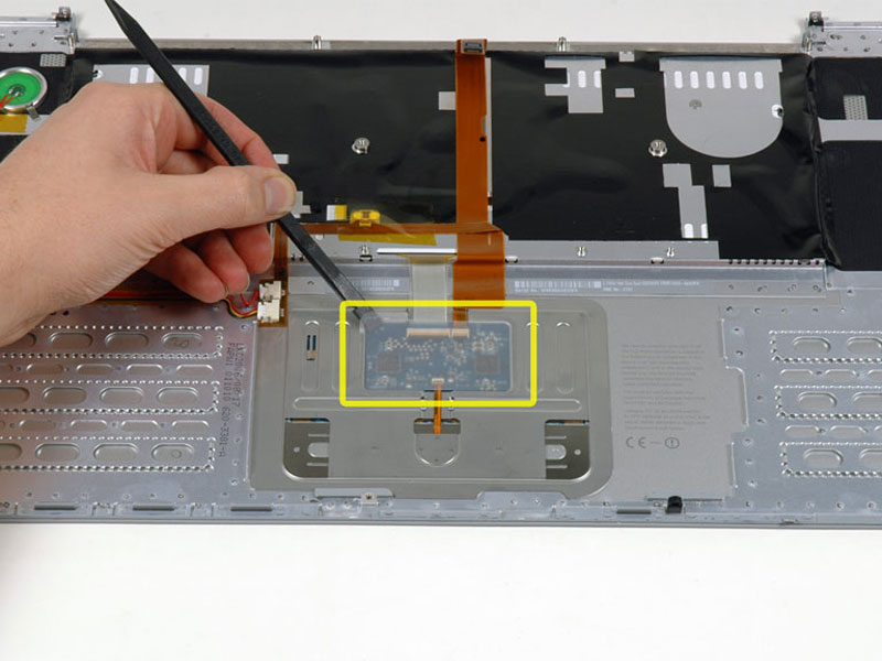

The ins and outs of replacing your upper case.
Image #1
  • Use your fingers to push both battery release tabs away from the battery, and lift the battery out of the computer.
Image #1
Add Note Edit Step 2 — Memory Door  ¶
  • Remove the three identical Phillips screws from the memory door.
  • Make sure to record which sets of screws came from where. This will help when re-assembling.
Image #1
Add Note Edit Step 3  ¶
  • Lift the memory door up enough to get a grip on it, and slide it toward you, pulling it away from the casing.
Image #1
Add Note Edit Step 4 — Upper Case  ¶
  • Remove the two Phillips screws in the battery compartment near the latch.
Image #1
Add Note Edit Step 5  ¶
  • Remove the following 6 screws:
    • Two 10 mm T6 Torx screws on either side of the RAM slot.
    • Four 14.5 mm Phillips screws along the hinge.
Image #1
Add Note Edit Step 6  ¶
  • Remove the four Phillips screws on the port side of the computer.
Image #1
Add Note Edit Step 7  ¶
  • Rotate the computer 90 degrees and remove the two Phillips screws from the rear of the computer.
Image #1
Add Note Edit Step 8  ¶
  • Rotate the computer 90 degrees again and remove the four Phillips screws from the side of the computer.
