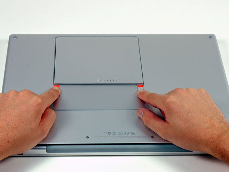

  • Use your fingers to push both battery release tabs away from the battery, and lift the battery out of the computer.
first image
