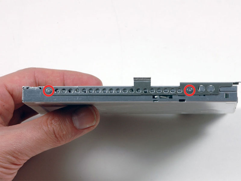

Add Note Edit Step 15 — Optical Drive Replacement  ¶
  • If your new optical drive already has brackets on it, you'll only need to transfer the data cable to your new drive.
  • Remove the two silver Phillips screws securing the mounting bracket to the left side of the optical drive.
