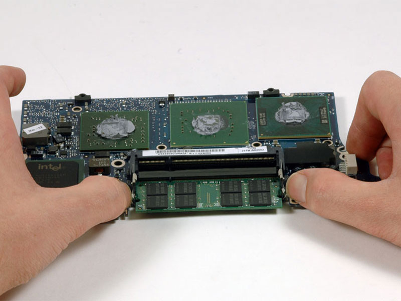

Add Note Edit Step 29 — Logic Board Replacement  ¶
  • Release the tabs on each side of the RAM chip at the same time. These tabs lock the chip in place and releasing them will cause the chip to "pop" up.
  • Pull the chip directly out from its connector.
  • If there are two RAM chips installed, repeat the above procedure for the second chip.
