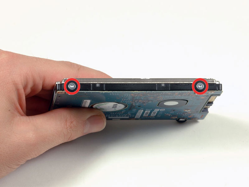

  17. MacBook Pro 15" Core Duo Model A1150 Hard Drive Replacement, Hard Drive: step 17, image 1 of 1
    • Remove the two silver T6 Torx screws and black rubber bumpers from the right side of the hard drive.
    • You'll need to transfer these screws and bumpers to your new hard drive if you're changing drives.
  18. MacBook Pro 15" Core Duo Model A1150 Hard Drive Replacement: step 18, image 1 of 1
    • Remove the two black T6 Torx screws and black rubber bumpers from the left side of the hard drive.
