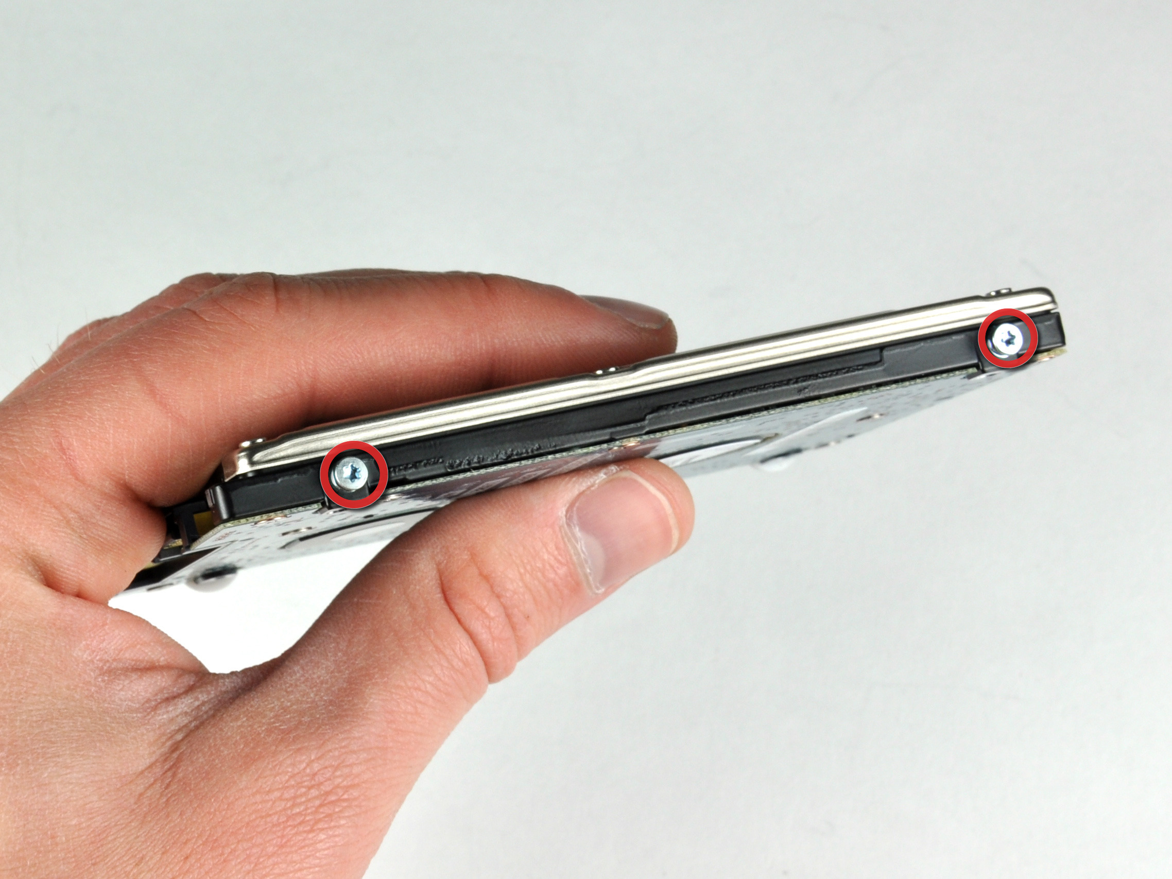

Add Note Edit Step 12 — Hard Drive Replacement  ¶
  • Remove the two silver T6 6 mm Torx screws from the left side of the hard drive.
  • You'll need to transfer these screws to your new hard drive if you're changing drives.
