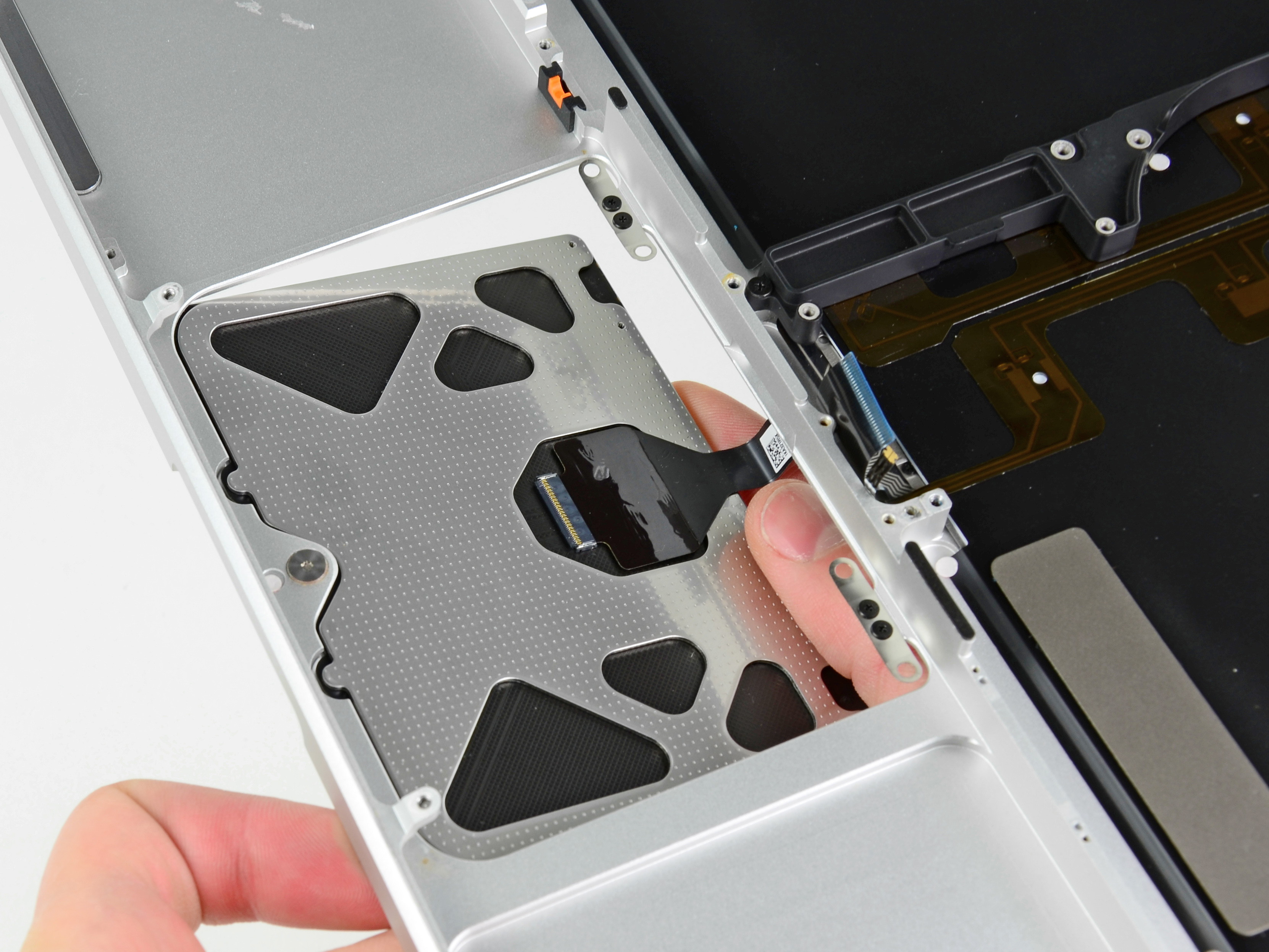

  43. MacBook Pro 13" Unibody Early 2011 Upper Case Replacement, Upper Case: step 43, image 1 of 1
    • Remove the four 1.2 mm Phillips screws highlighted in red.

    • Carefully dislodge the edge of the trackpad closest to the keyboard from its recess in the upper case by pushing it away from the brackets attached to the upper case.
    • De-route the trackpad cable through its slot cut into the upper case.
  45. MacBook Pro 13" Unibody Early 2011 Upper Case Replacement: step 45, image 1 of 1
    • Pull the trackpad away from the outer edge of the upper case.
    • Remove the trackpad and set it aside.
