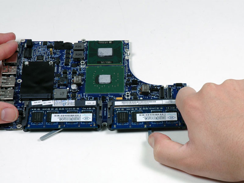

Add Note Edit Step 36 — Logic Board Replacement  ¶
  • Turn the logic board over.
  • Peel the PRAM battery up from its location on the logic board, removing tape as necessary.
  • If you have a Macbook Core 2 Duo Santa Rosa/Penryn, the PRAM battery is not located on the logic board. Please skip this step.
first image
Add Note Edit Step 37  ¶
  • Disconnect the PRAM battery cable from the logic board and remove the PRAM battery from the computer.
first image
Add Note Edit Step 38  ¶
  • Pull back on the metal lever and slide the RAM chip out of the logic board.
  • Repeat this process for the other RAM chip if there are two RAM chips currently installed in your computer.
For more information, check out the MacBook Core 2 Duo device page.
