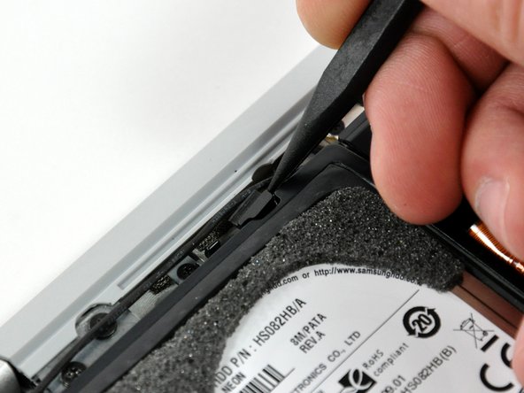

  • Use the sharp end of a spudger to de-route the microphone cable from the hard drive bracket.
  • Remove the cosmetic screw cover from the adhesive securing it to the hard drive bracket.

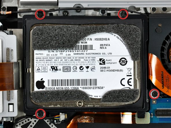

  • Remove the four Phillips screws securing the hard drive assembly to the upper case.
Image #1

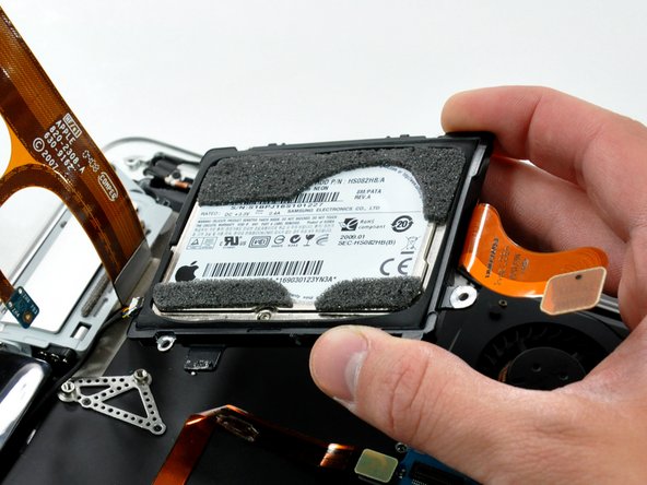

Image #1 Image #2

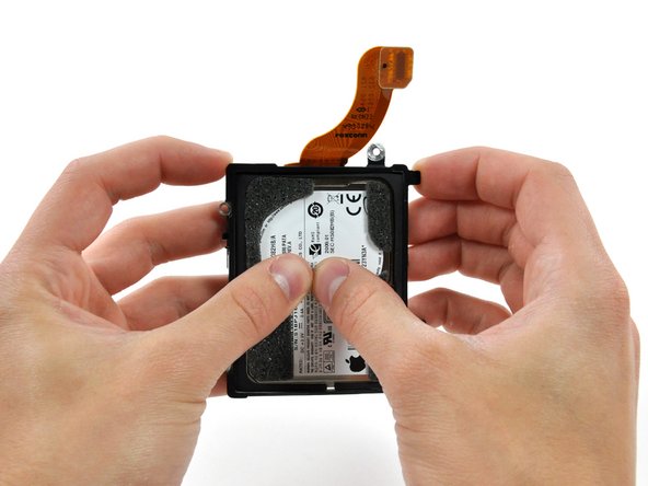

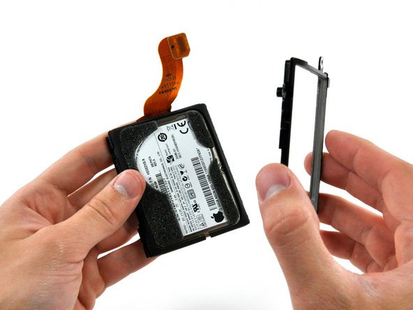

Add Note Edit Step 12 — Hard Drive Replacement  ¶
  • Use your thumbs to push the hard drive away from its bracket.
Image #1 Image #2

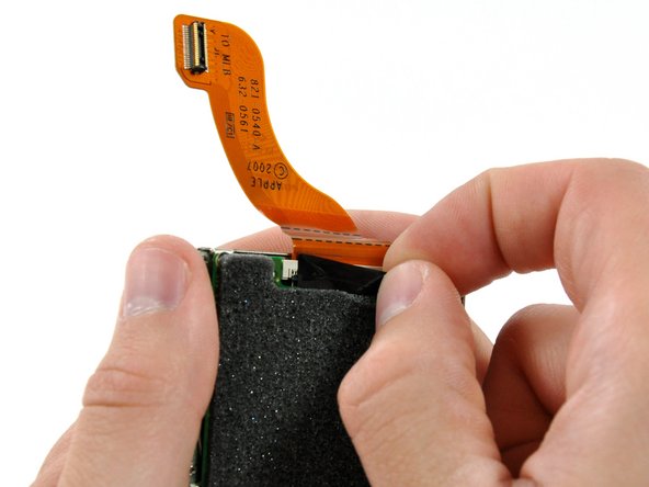

  • The two different versions of MacBook Air have different hard drive connectors. Failure to perform the action appropriate to your machine will damage your hard drive! Be very careful when disconnecting the hard drive cable. The ZIF connectors are fragile.
  • If you have the original MacBook Air (A1237), use a spudger or your thumbs to flip up the ribbon cable retaining flap TOWARD the cable (seen in picture 1).

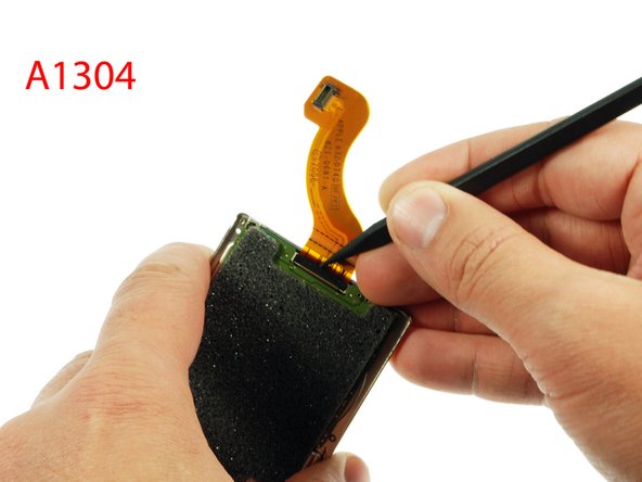

  • If you have the A1304 version of MacBook Air, use a spudger or your thumbs to flip up the ribbon cable retaining flap AWAY from the cable (seen in picture 2).

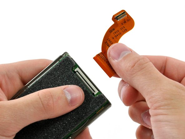

  • Pull the hard drive cable straight away from its socket.

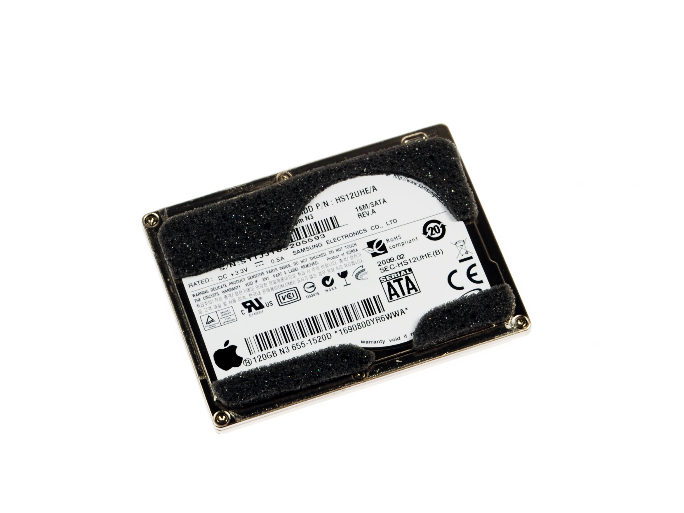

  • If you are installing a new hard drive, we have an OS X install guide to get you up and running.
  • If you need to, transfer the foam from your current hard drive to the new one. The foam does come off by using a spudger and some patience.
