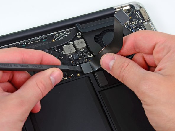

  4. MacBook Air 13" Mid 2011 Upper Case Replacement, I/O Board Cable: step 4, image 1 of 1
    • Use the flat end of a spudger to pry the I/O board cable connector upward out of its socket on the I/O board.
  5. MacBook Air 13" Mid 2011 Upper Case Replacement: step 5, image 1 of 1
    • Carefully peel the I/O board cable from the top of the fan.

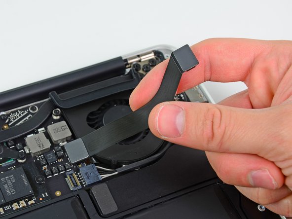

  6. MacBook Air 13" Mid 2011 Upper Case Replacement: step 6, image 1 of 2 MacBook Air 13" Mid 2011 Upper Case Replacement: step 6, image 2 of 2
    • The following connector has an especially deep socket. Use care when disconnecting it.
    • While gently pulling the I/O board cable upward near its connection to the logic board, use the tip of a spudger to pry upward on alternating sides of the connector to help "walk" it out of its socket.
    • Remove the I/O board cable.

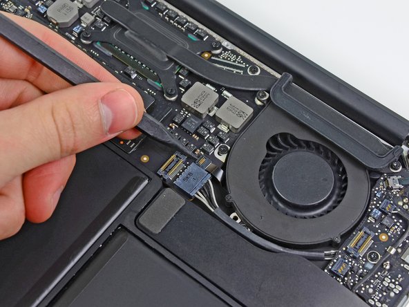

  7. MacBook Air 13" Mid 2011 Upper Case Replacement, Fan: step 7, image 1 of 1
    • Use the tip of a spudger to carefully flip up the retaining flap on the fan cable ZIF socket.

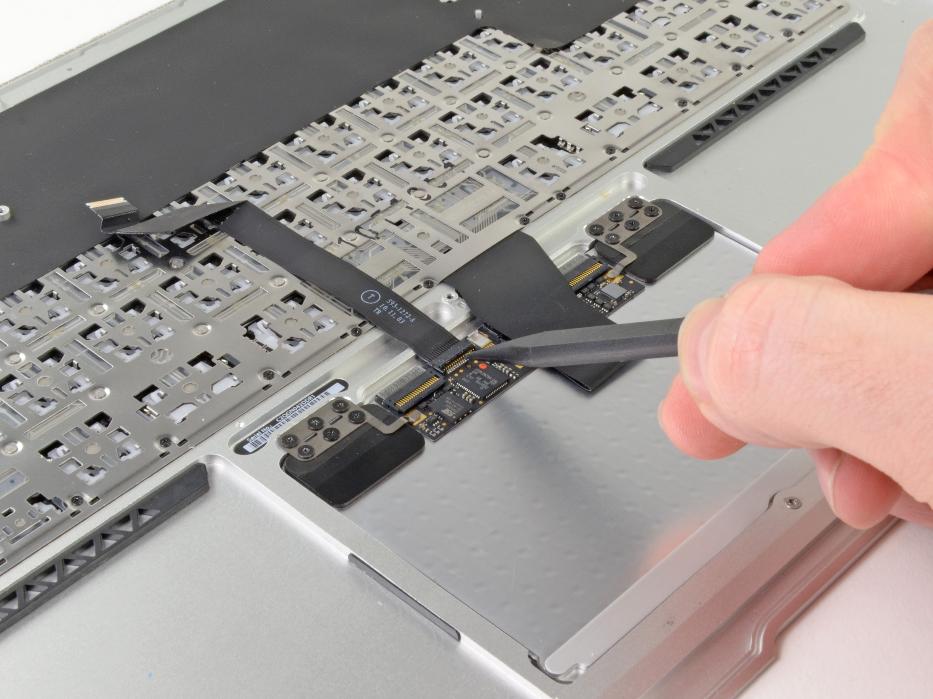

  39. MacBook Air 13" Mid 2011 Upper Case Replacement, Upper Case: step 39, image 1 of 2 MacBook Air 13" Mid 2011 Upper Case Replacement, Upper Case: step 39, image 2 of 2
    • Use the tip of a spudger or your fingernail to flip up the retaining flap on the trackpad ribbon cable ZIF socket.
    • Pull the trackpad ribbon cable straight out of its socket toward the rear edge of the Air.
  40. MacBook Air 13" Mid 2011 Upper Case Replacement: step 40, image 1 of 3 MacBook Air 13" Mid 2011 Upper Case Replacement: step 40, image 2 of 3 MacBook Air 13" Mid 2011 Upper Case Replacement: step 40, image 3 of 3
    • While carefully lifting the keyboard ribbon cable with one hand, use the tip of a spudger or your fingernail to flip up the retaining flap on the keyboard ribbon cable ZIF socket.
    • Pull the keyboard ribbon cable straight out of its socket toward the front edge of the Air.

On reassembly with a new upper case I spent a long time trying to replace the red-circled screw to hold the fan. After a while I figured out that the new case I purchased from IFIXIT had a small screw already inserted in the socket. Once I removed this extra part everything went smoothly.
wlnem - Reply
THAT’S why I ended up with an extra screw!
I agree, this guide is great. Was able to skip the last few steps, as my replacement upper case was already assembled.
