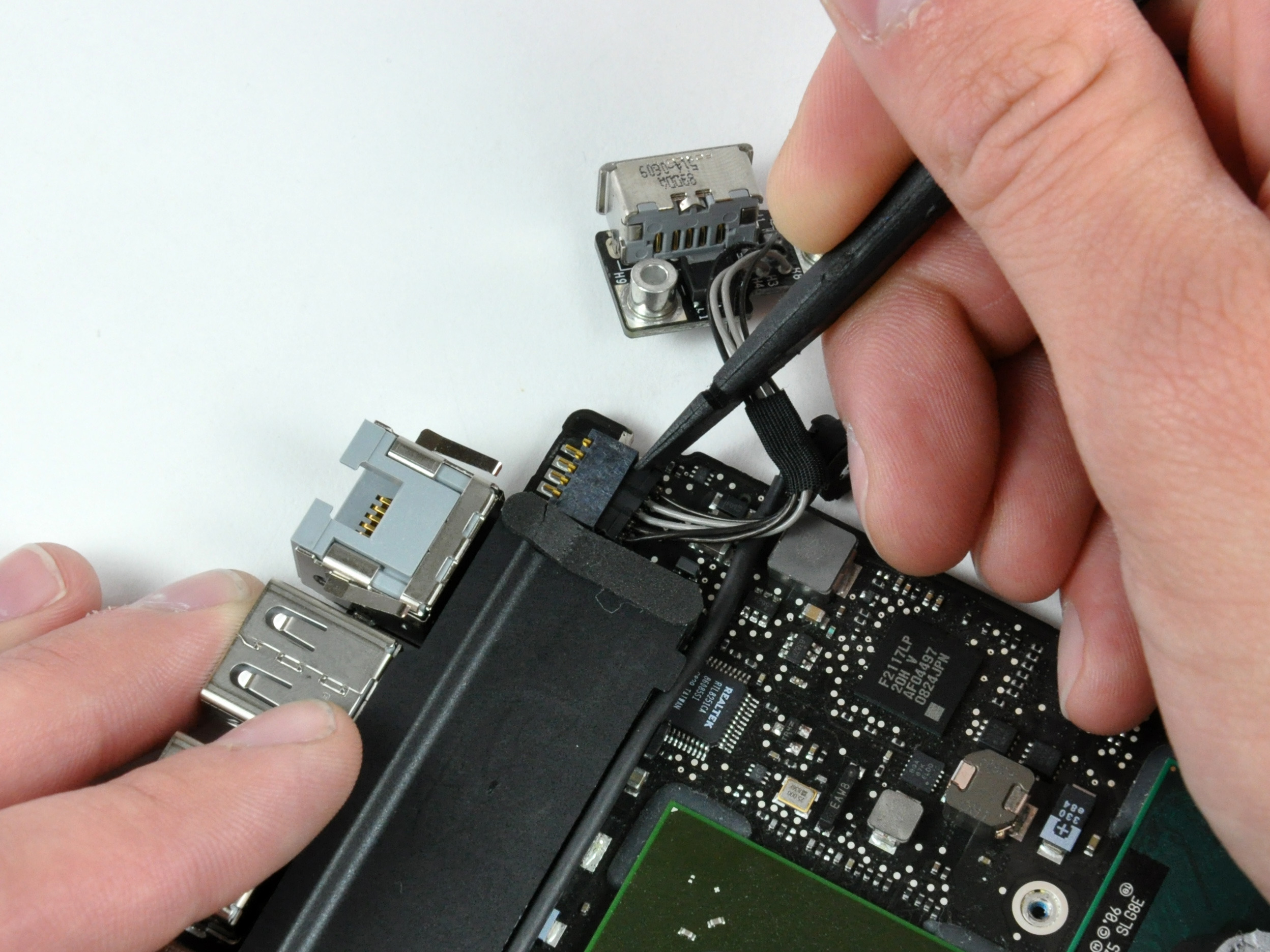

  31. MacBook Unibody Model A1278 Logic Board Replacement, Logic Board: step 31, image 1 of 1
    • Disconnect the DC-In Board from the logic board by pulling its connector straight away from the socket on the logic board.
