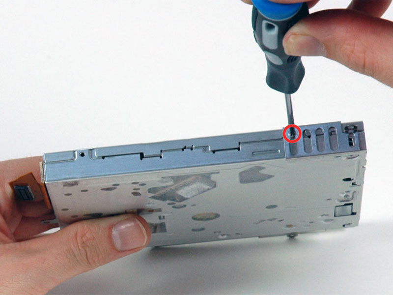

    • Remove the single Phillips screw securing the mounting bracket to the left side of the optical drive.

  17. MacBook Pro 17" Models A1151 A1212 A1229 and A1261 Optical Drive Replacement: step 17, image 1 of 1
    • Rotate the drive and remove the single Phillips screw securing the mounting bracket to the right side of the optical drive.
    • If you purchased an optical drive without mounting brackets, simply transfer the three silver metal brackets and orange ribbon cable to your new optical drive.
