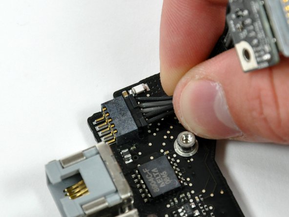

Add Note Edit Step 33  ¶
  • Disconnect the DC-In Board connector from the logic board by pulling it straight away from its socket.

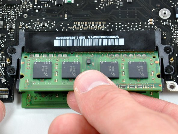

Image #1

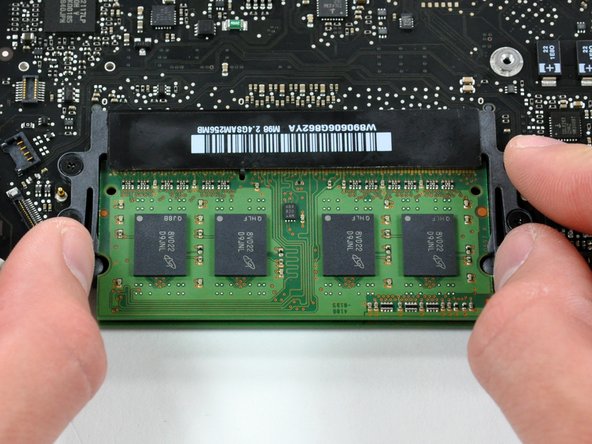

Add Note Edit Step 34  ¶
  • Release the tabs on each side of the RAM chip by simultaneously pushing each tab away from the chip.
  • These tabs lock the chip in place and releasing them will cause the chip to "pop" up.
Image #1
Add Note Edit Step 35  ¶
  • After the RAM chip has popped up, pull it straight out of its socket.
  • Repeat this process if a second RAM chip is installed.
  • When reinstalling your logic board, don't forget to apply a new layer of thermal paste.
