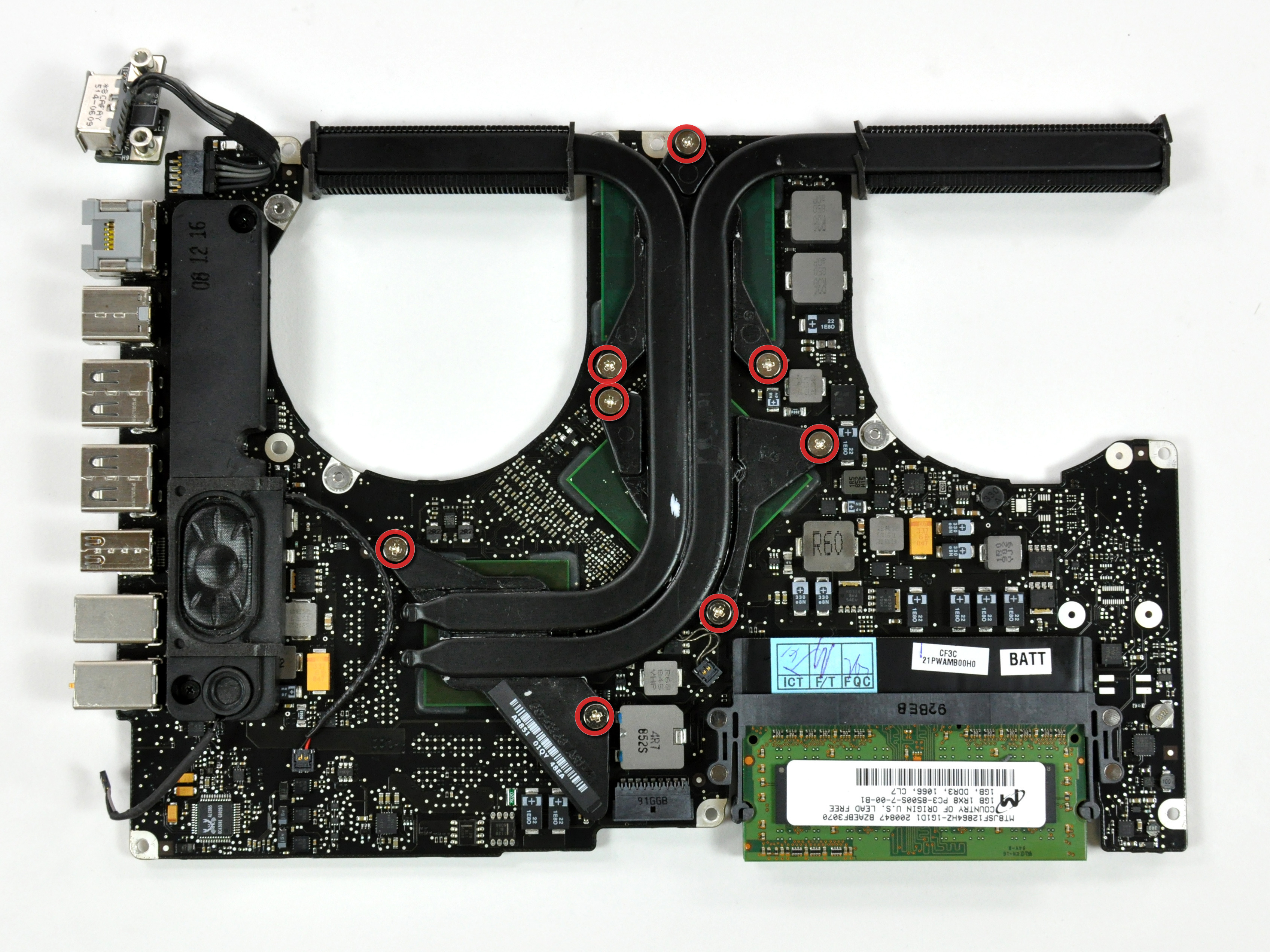

  28. MacBook Pro 15" Unibody Late 2008 and Early 2009 Logic Board Replacement, Logic Board: step 28, image 1 of 1
    • Remove eight 8.4 mm Phillips screws securing the heat sink to the logic board.
    • Don't remove the heat sink yet! There is a delicate connector that must first be disconnected.
    • A spring is held under each of these screws.
