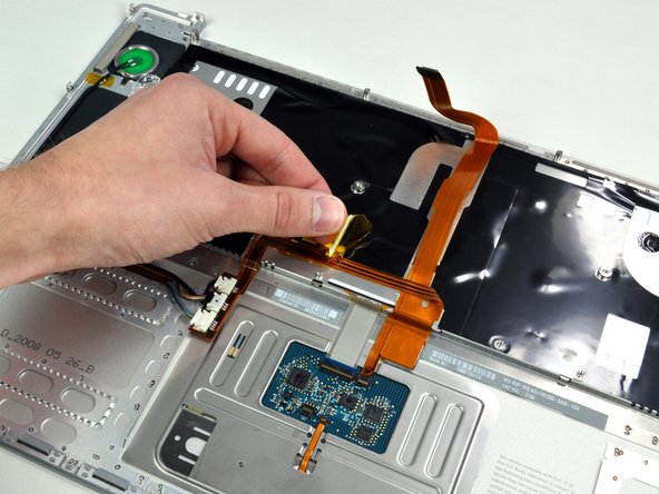

  • Disconnect the trackpad and keyboard ribbon cable from the logic board, removing tape as necessary.
  • Note: It is possible to replace the hard drive without disconnecting the keyboard from the chassis, but it will need to be held upright to keep it out of the way, while still allowing you both hands to work on the drive removal. Be careful when removing the keyboard-trackpad ribbon cable to ensure that the rear of the upper case is disengaged from the area near the hinge. It is easy to accidentally bend the screw receivers on either side of the keyboard.
    • Remove the upper case.

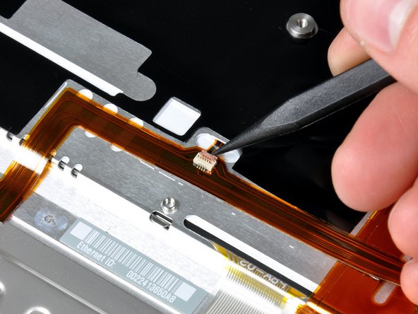

Add Note Edit Step 10 — Upper Case Cable Replacement  ¶
  • Use a spudger to pry up the translucent plastic sheet covering the keyboard connector. You can just peel up the three sides closest to the upper flex cable entering the keyboard connector to make it easier to reassemble it.

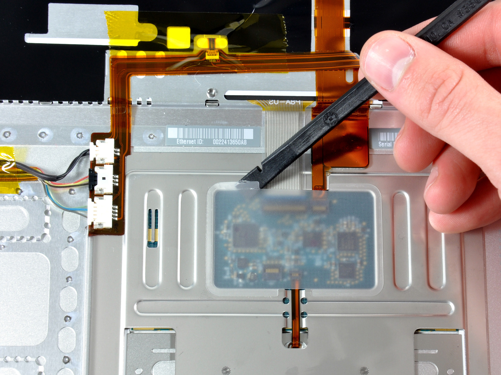

Add Note Edit Step 11  ¶
  • Use the tip of a spudger to flip up the black plastic flap locking down the orange upper case ribbon cable. Similar to the other locking flaps it is located on the opposite side of where the cable enters the connection.

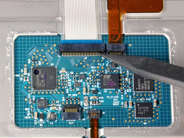

Add Note Edit Step 12  ¶
  • Peel up the orange tape covering the keyboard backlight connector.

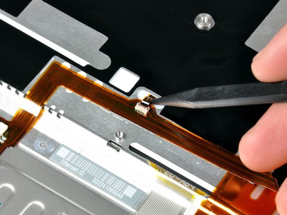

Add Note Edit Step 13  ¶
  • Use the tip of a spudger to flip up the brown plastic flap locking down the keyboard backlight ribbon cable.

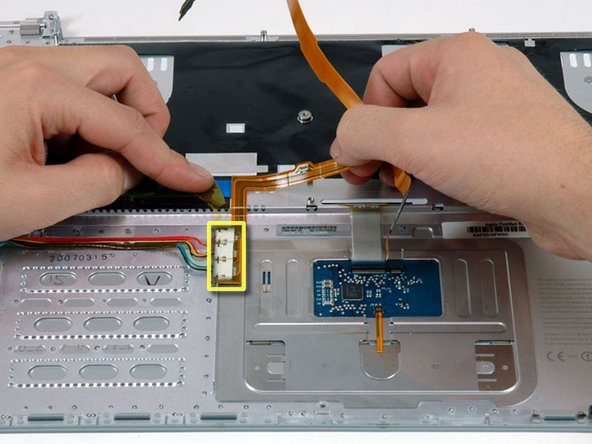

Add Note Edit Step 15  ¶
  • Disconnect the power button cable, the bluetooth cable, and the sleep sensor cable.
  • Carefully peel up the orange ribbon cable removing tape as necessary.
