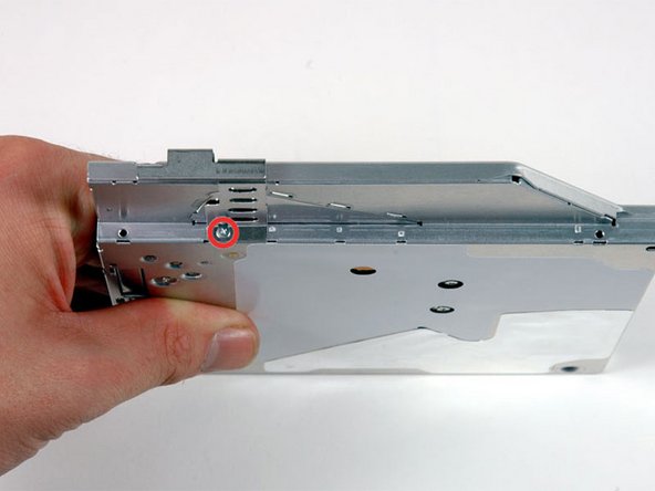

Add Note Edit Step 17  ¶
  • Rotate the drive and remove the single Phillips screw securing the mounting bracket to the right side of the optical drive.
  • If you purchased an optical drive without mounting brackets, simply transfer the three silver metal brackets and orange ribbon cable to your new optical drive.
  • If you have a CD or any other object jammed in your optical drive, we have an optical drive repair guide.
