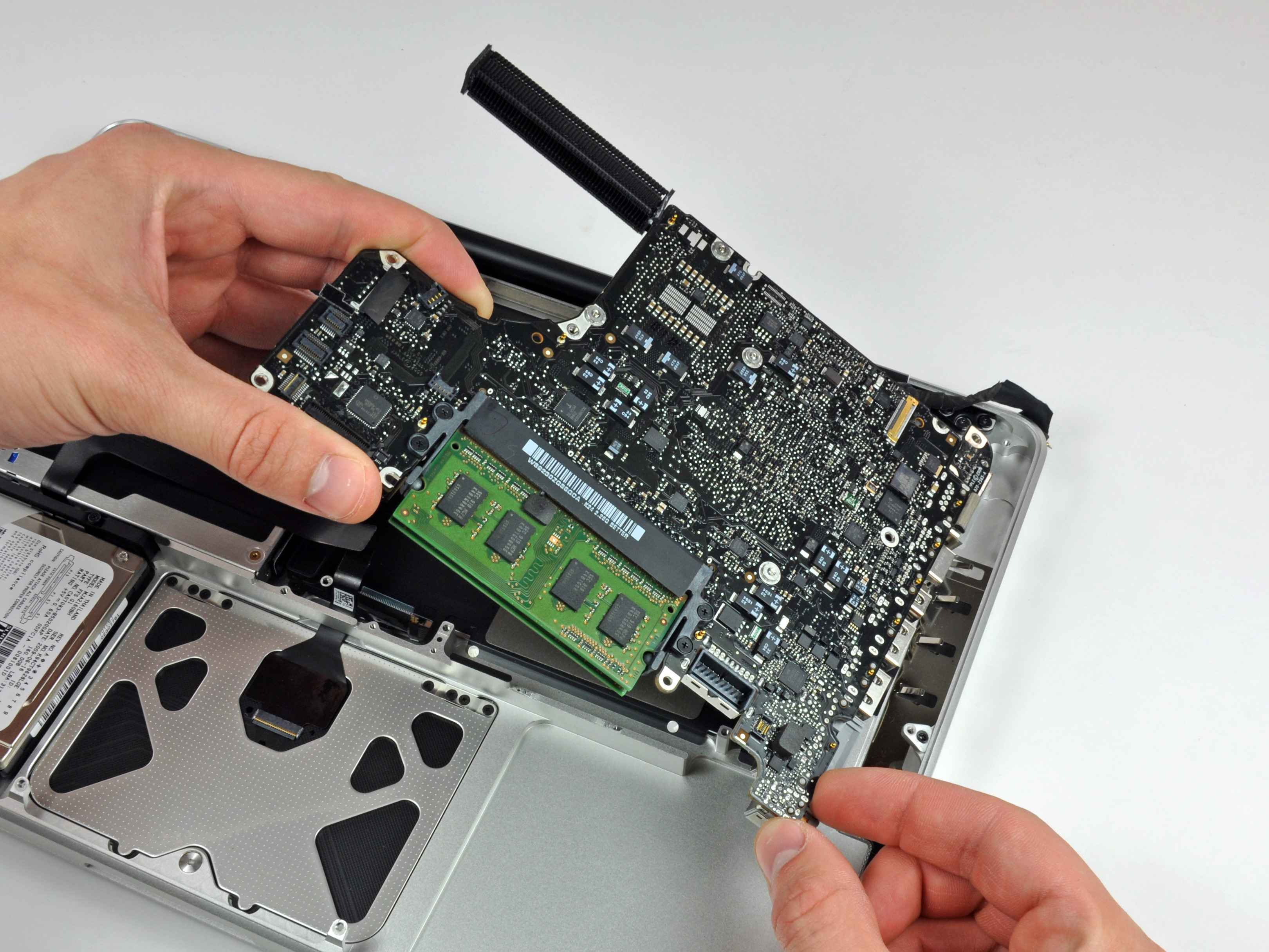

  19. MacBook Pro 13" Unibody Mid 2009 Logic Board Replacement: step 19, image 1 of 2 MacBook Pro 13" Unibody Mid 2009 Logic Board Replacement: step 19, image 2 of 2
    • Lift the logic board from its left edge and raise it until the ports clear the side of the upper case.
    • Pull the logic board away from the side of the upper case and remove it, minding the DC-in board that may get caught.
    • Be careful not to rip out the fragile connector plug of the microphone assembly.
