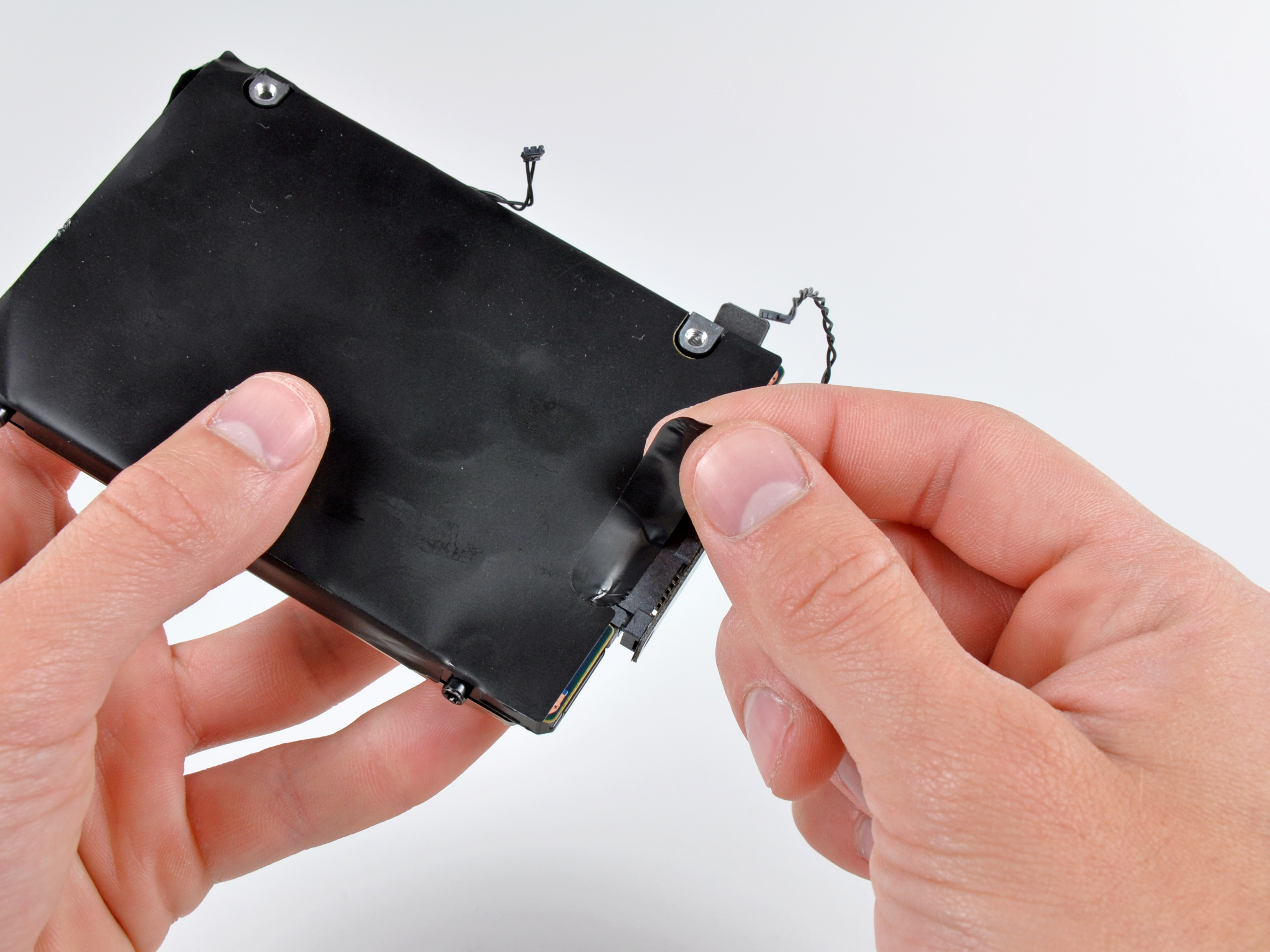

Add Note Edit Step 18 — Hard Drive Replacement  ¶
  • Remove the strip of tape covering the hard drive connector.
first image
