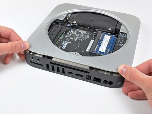

  • Place your thumbs in the depressions cut into the bottom cover.
  • Rotate the bottom cover counter-clockwise until the white dot painted on the bottom cover is aligned with the ring inscribed on the outer case.
Image #1
Add Note Edit Step 2  ¶
  • Tilt the mini enough to allow the bottom cover to fall away from the outer case.
  • Remove the bottom cover and set it aside.

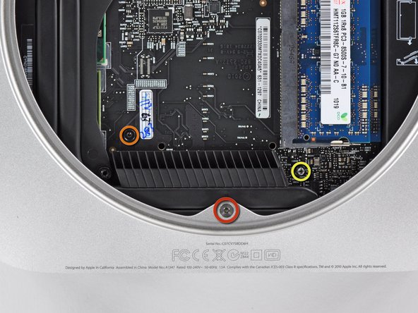

Add Note Edit Step 6 — Cowling  ¶
  • Remove the single 3.5 mm T6 Torx screw securing the cowling to the heat sink.
Image #1

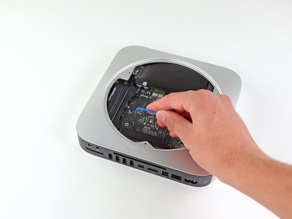

Add Note Edit Step 10  ¶

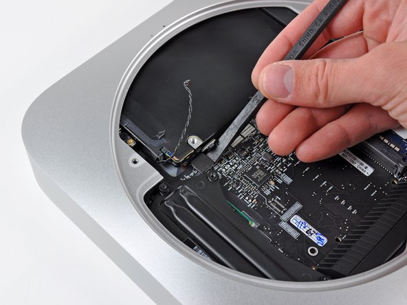

  • Use the tip of a spudger to carefully pry the antenna connector up off the AirPort/Bluetooth board.
Image #1

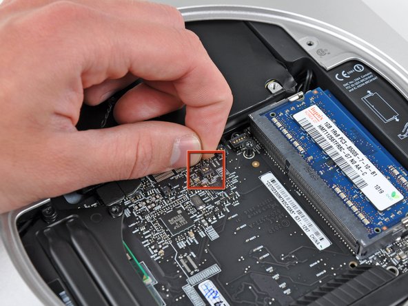

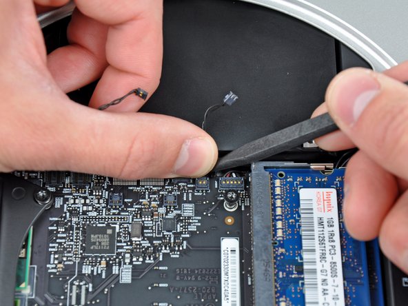

  • Carefully pull the wires for both hard drive thermal sensors upward to lift their connectors up and out of the sockets on the logic board.
Image #1 Image #2

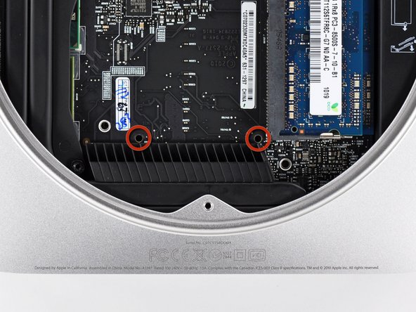

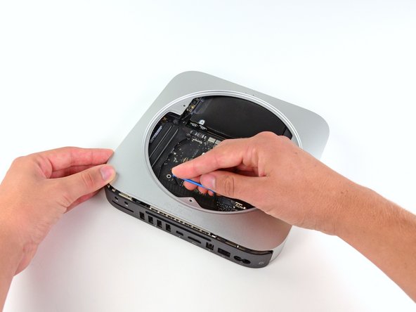

  • To remove the logic board, two cylindrical rods must be inserted into the holes highlighted in red. Inserting instruments into any logic board holes other than the ones highlighted in red may destroy the logic board.
  • Insert a Mac Mini Logic Board Removal Tool into the two holes highlighted in red. Be sure it makes contact with the outer case below the logic board before proceeding.
  • If you don't have a Logic Board Removal Tool handy, you can use two tools having a maximum diameter of 2.5 mm instead. Just insert one into each of the highlighted holes.
  • Carefully pull the tool toward the I/O board. The logic board and I/O board assembly should slightly slide out of the outer case.
  • Cease prying when the I/O board is visibly separated from the outer case. Remove the Mac Mini Logic Board Removal tool.

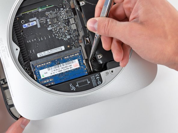

Add Note Edit Step 19  ¶
  • Pull the I/O board/logic board assembly out of the outer case enough to access the power connector.
  • Use a pair of tweezers to disconnect the power cable from the logic board.
  • Pull the power cable connector toward the optical drive opening.
Image #1

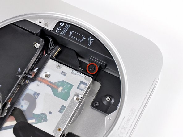

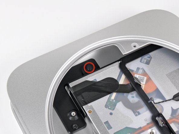

  • Remove the 7.9 mm T6 Torx screw securing the power supply and optical drive to the outer case.
Image #1 Image #2

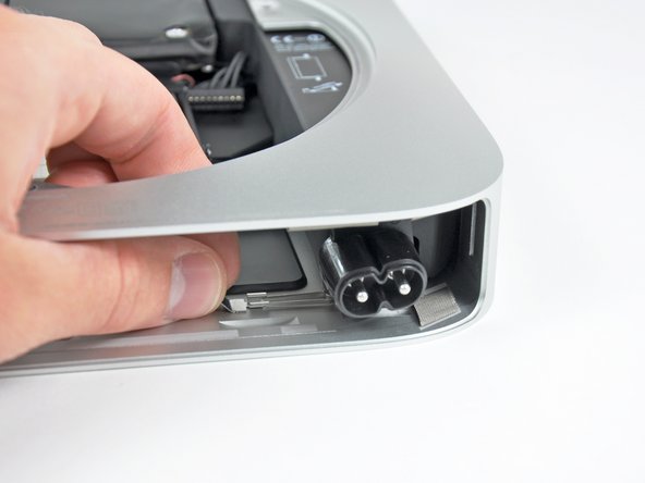

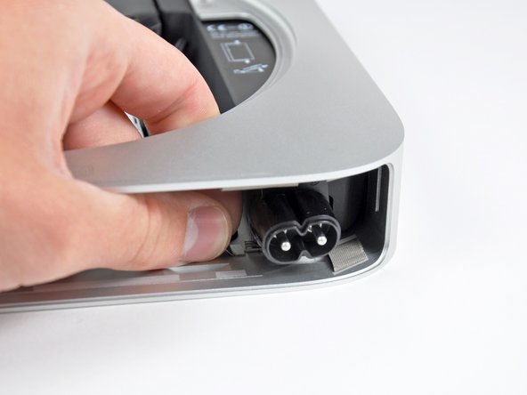

Add Note Edit Step 22  ¶
  • Pull the silver metal AC-In socket retainer away from the side of the outer case and remove it from the mini.
Image #1 Image #2

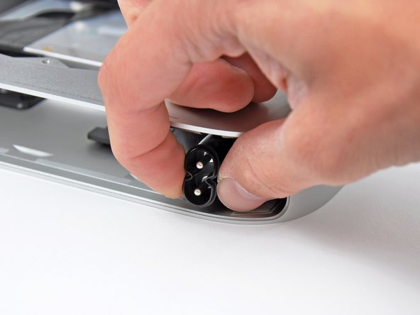

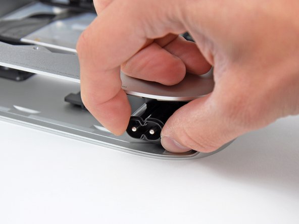

Add Note Edit Step 23  ¶
  • Rotate the AC-In connector 90 degrees counter-clockwise.
Image #1

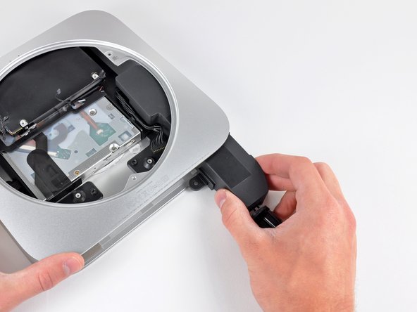

Add Note Edit Step 24  ¶
  • Slide the power supply out of the mini, minding any cables that may get caught.
Image #1

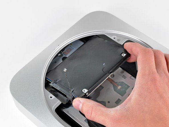

Add Note Edit Step 25 — Optical Drive  ¶
  • Remove the hard drive from the mini, minding any cables that may get caught.
Image #1

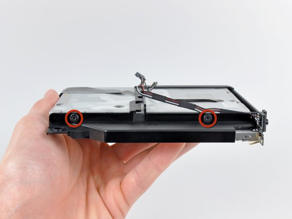

Add Note Edit Step 29  ¶
  • Remove the two 6.3 mm T6 Torx screws securing both sides of the optical drive bracket to the optical drive (four screws total).
Image #1

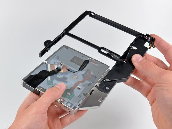

Add Note Edit Step 30  ¶
  • Remove the optical drive bracket from the optical drive, minding any cables that may get caught.
Image #1

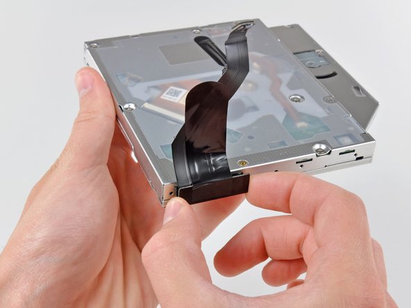

Add Note Edit Step 31  ¶

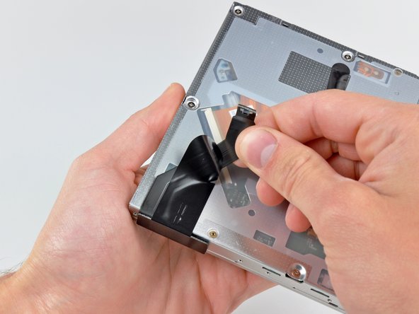

  • Carefully peel the optical drive ribbon cable off the body of the optical drive.
Image #1
Add Note Edit Step 32  ¶
  • Disconnect the optical drive cable by pulling its connector away from the body of the optical drive.
Image #1

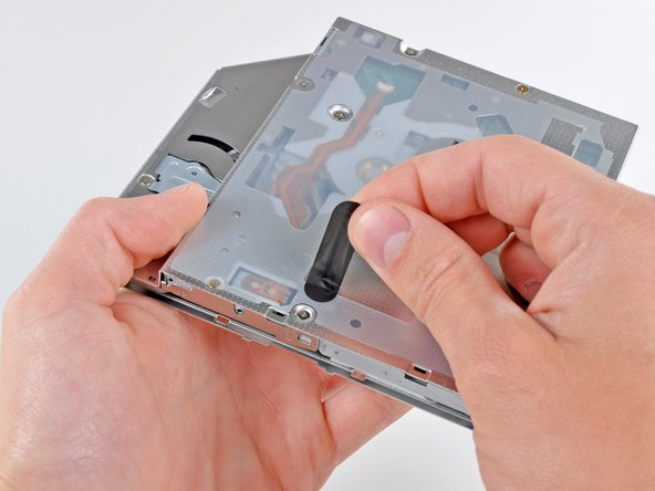

Add Note Edit Step 33  ¶
  • Peel off the strip of black tape covering the optical drive thermal sensor.
Image #1

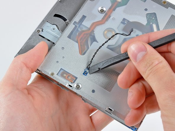

Add Note Edit Step 34  ¶
  • Carefully pry the optical drive thermal sensor off the adhesive securing it to the optical drive.
  • It may be necessary to use a strip of tape or rubber cement to attach the thermal sensor to your new optical drive.
