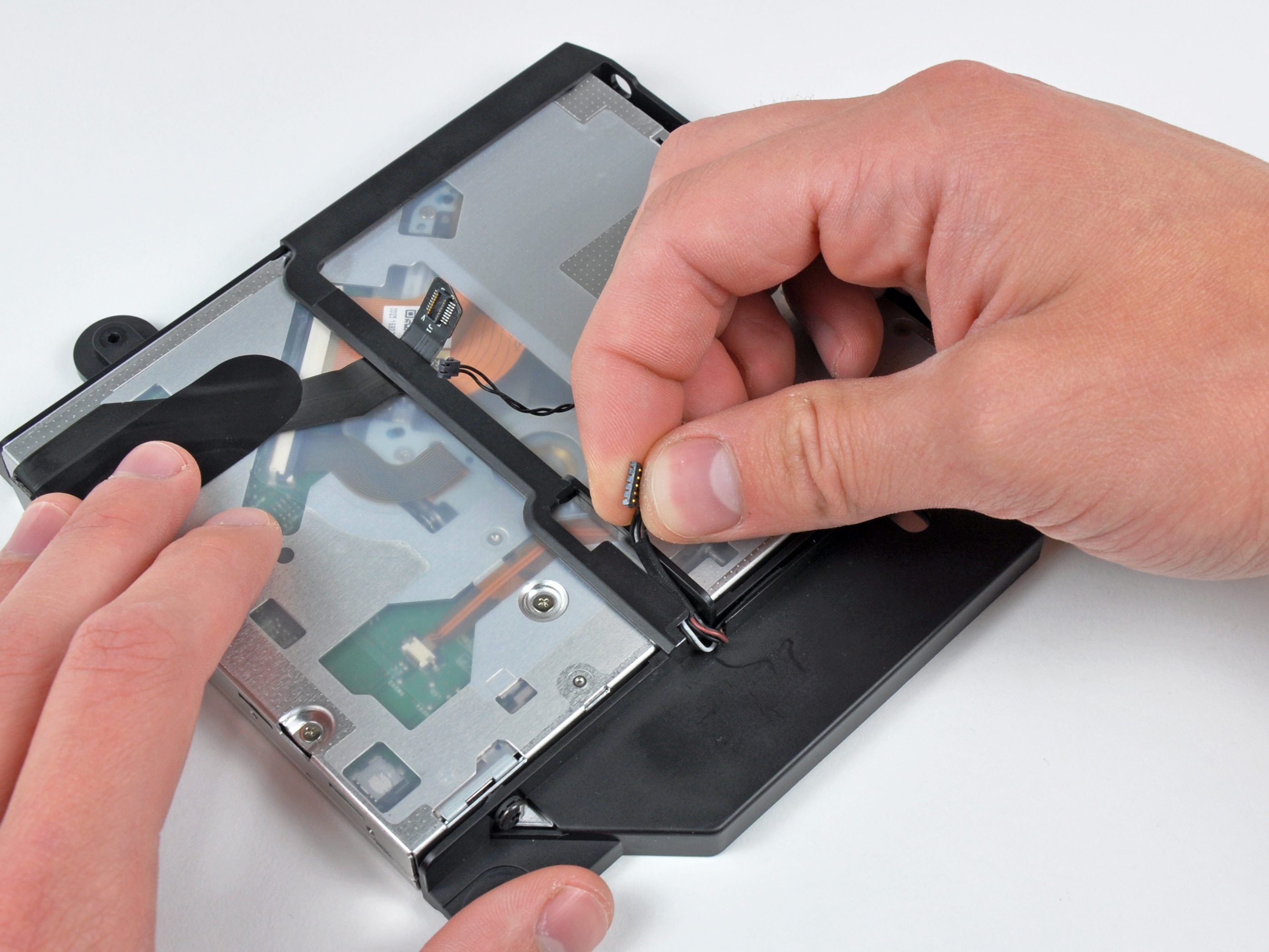

  28. Mac mini Model A1347 Optical Drive Replacement, Optical Drive: step 28, image 1 of 1
    • Carefully de-route the IR sensor cables from the channel in the optical drive bracket.
  29. Mac mini Model A1347 Optical Drive Replacement: step 29, image 1 of 2 Mac mini Model A1347 Optical Drive Replacement: step 29, image 2 of 2
    • Remove the two 6.3 mm T6 Torx screws securing both sides of the optical drive bracket to the optical drive (four screws total).
  30. Mac mini Model A1347 Optical Drive Replacement: step 30, image 1 of 1
    • Remove the optical drive bracket from the optical drive, minding any cables that may get caught.
  31. Mac mini Model A1347 Optical Drive Replacement: step 31, image 1 of 1
    • Carefully peel the optical drive ribbon cable off the body of the optical drive.
  32. Mac mini Model A1347 Optical Drive Replacement: step 32, image 1 of 1
    • Disconnect the optical drive cable by pulling its connector away from the body of the optical drive.
  33. Mac mini Model A1347 Optical Drive Replacement: step 33, image 1 of 1
    • Peel off the strip of black tape covering the optical drive thermal sensor.
  34. Mac mini Model A1347 Optical Drive Replacement: step 34, image 1 of 1
    • Carefully pry the optical drive thermal sensor off the adhesive securing it to the optical drive.
    • It may be necessary to use a strip of tape or rubber cement to attach the thermal sensor to your new optical drive.
    • If you have a CD or any other object jammed in your optical drive, we have an optical drive repair guide.
