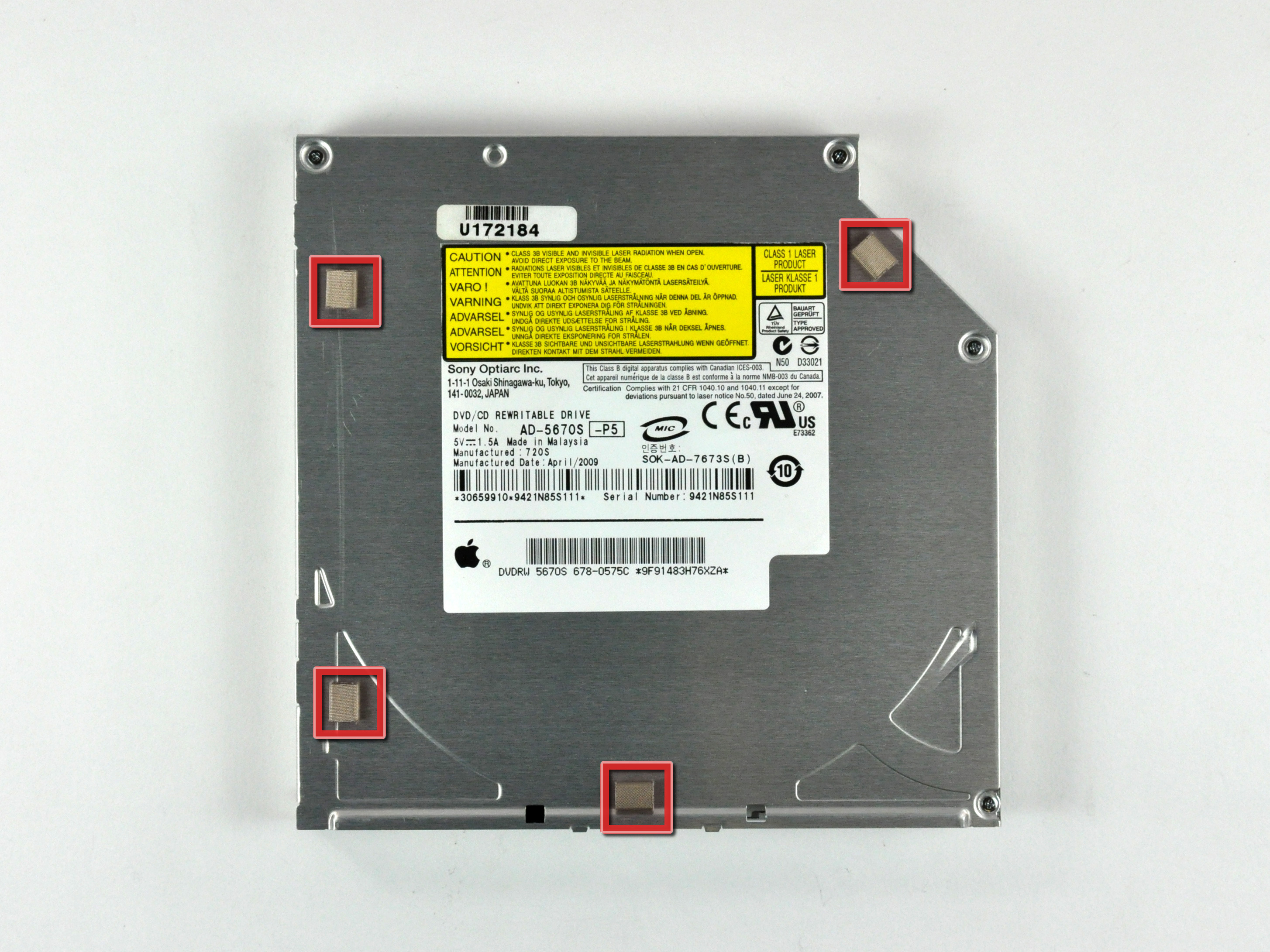

  • Turn the mini 180 degrees and remove the two Phillips screws securing the optical drive to the internal frame on the other side.
Image #1
Add Note Edit Step 18  ¶
  • Remove the two Phillips screws securing the interconnect board to the optical drive.
Image #1
Add Note Edit Step 19  ¶
  • Insert the flat end of a spudger into the crevice between the optical drive and the interconnect board.
  • Carefully increase the crevice to disconnect the optical drive from the interconnect board.
Image #1
Add Note Edit Step 20  ¶
  • Gently lift the optical drive out of the internal frame.
Image #1
Add Note Edit Step 21 — Optical Drive Replacement  ¶
  • Transfer the four foam bumpers to the replacement optical drive.
