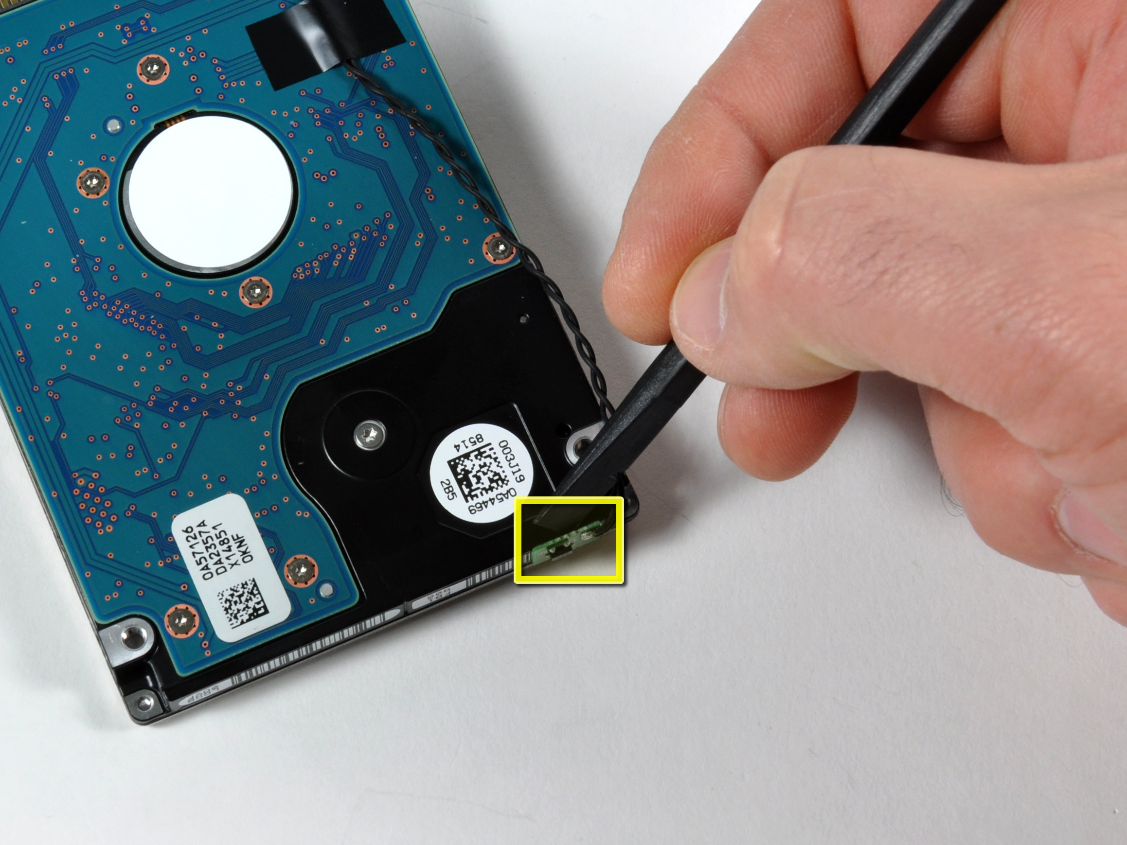

    • Use the flat end of a spudger to pry the hard drive thermal sensor board off the adhesive securing it to the side of the hard drive.

You don't need to remove the connector of the HD temperature sensor from the interconnection board, just detach the sensor from the drive. Then you can still get the drive out. My sensor connector unfortunately broke off completly. I managed to solder the sensor wires directly to the tiny contacts on the board :))
Chris Tyson - Reply
Step 16: Is the thermal sensor necessary if I am replacing HDD with an SDD? If so, where should it be attached?
Brian - Reply
