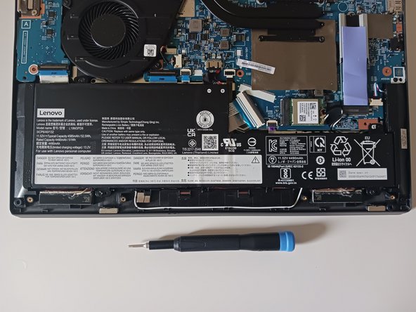

  2. Lenovo IdeaPad 5-14ALC05 Battery Replacement, Disconnect the battery: step 2, image 1 of 3 Lenovo IdeaPad 5-14ALC05 Battery Replacement, Disconnect the battery: step 2, image 2 of 3 Lenovo IdeaPad 5-14ALC05 Battery Replacement, Disconnect the battery: step 2, image 3 of 3
    • With the back panel removed, we have access to all of the internals.
    • Using your spudger or thumbnail, disconnect the battery cable from the motherboard. This will prevent any damage to the electronics or battery during the operation.
  3. Lenovo IdeaPad 5-14ALC05 Battery Replacement, Remove the battery: step 3, image 1 of 3 Lenovo IdeaPad 5-14ALC05 Battery Replacement, Remove the battery: step 3, image 2 of 3 Lenovo IdeaPad 5-14ALC05 Battery Replacement, Remove the battery: step 3, image 3 of 3
    • Using a 00 Philips-Head screwdriver, remove the four screws holding the battery.
    • One screw is covered by a sticker. To remove it, just apply enough downward pressure with your screwdriver to break through the sticker.
    • As there is no adhesive holding the battery in place, we can easily remove it.
  4. Lenovo IdeaPad 5-14ALC05 Battery Replacement, Put in the new battery: step 4, image 1 of 2 Lenovo IdeaPad 5-14ALC05 Battery Replacement, Put in the new battery: step 4, image 2 of 2
    • Remove the battery completely and put in the new battery.
