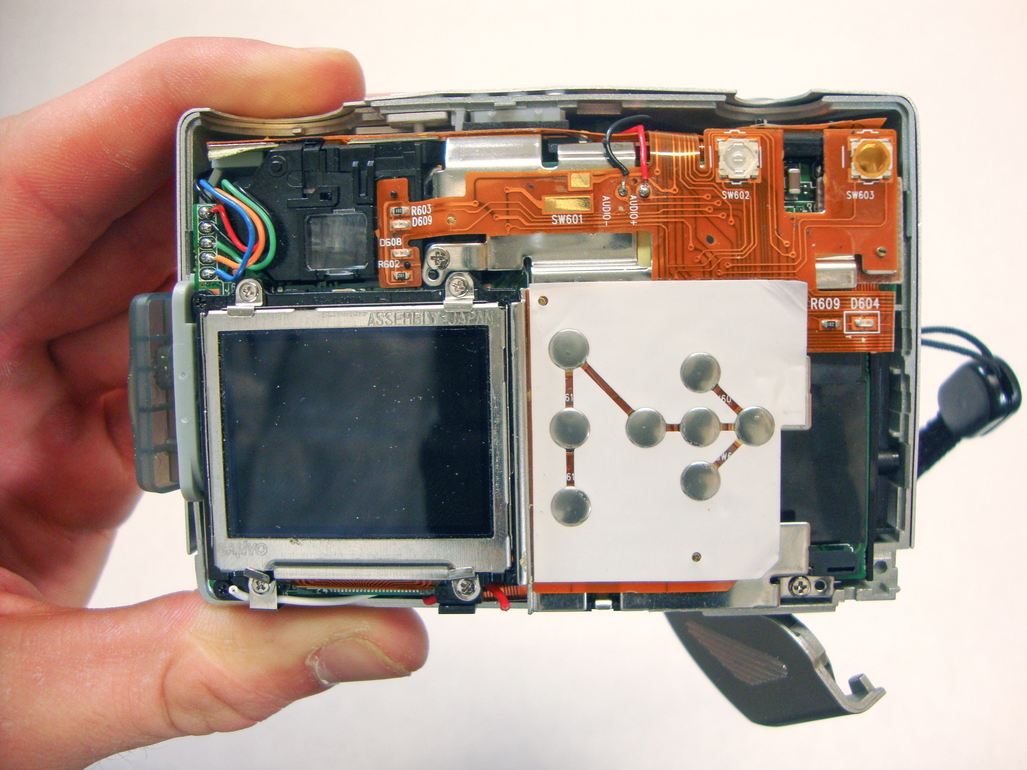

Image #1 Image #2 Image #3
Add Note Edit Step 7  ¶
  • Use your thumbs to pry the case apart.
  • It is easiest to pry to case apart if your start at the bottom.
  • The case should come apart with minimal effort. If it doesn't, you can use a tool such as a Spudger or Plastic Opening tool.
Image #1
Add Note Edit Step 8  ¶
  • This step requires a significant amount of force.
  • Pull the bottom half of the inner camera out of case about half an inch. This may be difficult and force is necessary.
