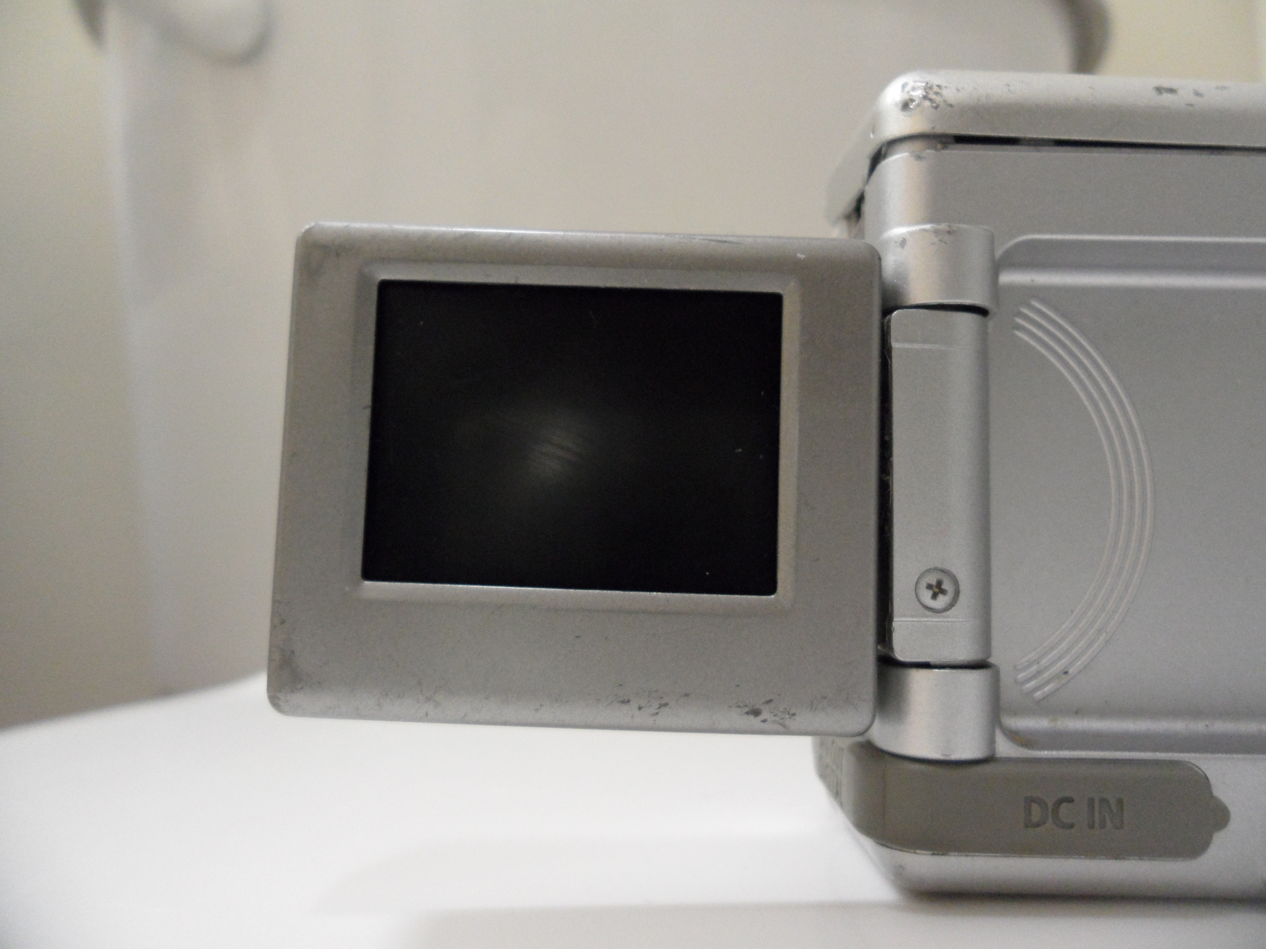

  • Unscrew the two 2.9 mm screws on the side of the screen that connect the front and back cover of the LCD screen. Use a #00 screwdriver.
Image #1 Image #2

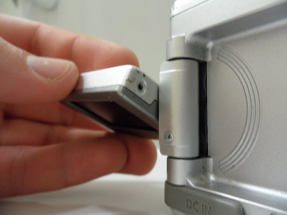

  • Unscrew the 2.9 mm side screws on the other side of the screen using the #00 screwdriver. These also hold the screen covers together.
  • To get to the second screw, rotate the screen.

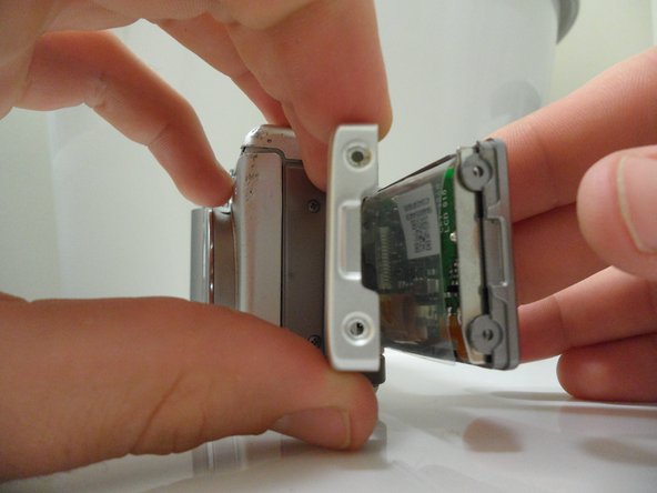

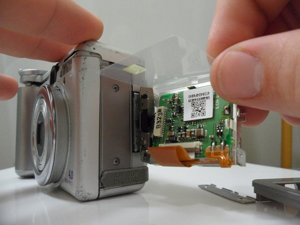

  • Gently peel off the front and back cover of the screen.
  • Peel back the plastic cover.
Image #1
Add Note Edit Step 4  ¶

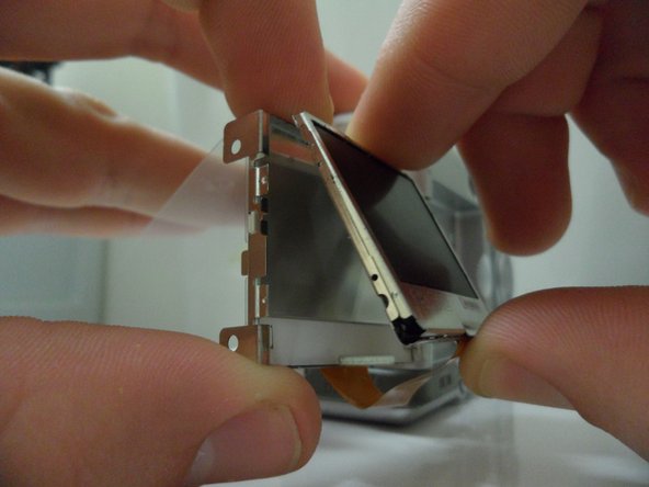

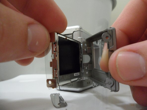

  • Gently pull off the screen from the base.
  • A small metal piece between the screen cover and the screen may fall out during repair. remember to replace it with the rounded corners facing away from the screen during reassembly.
  • This takes a little force.

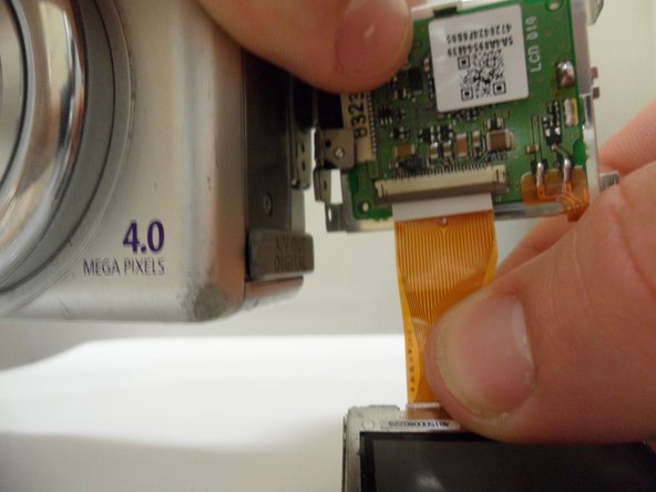

Add Note Edit Step 5  ¶
  • Unplug the wires that are attaching the screen to the circuit board.
