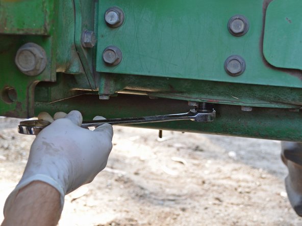

  4. John Deere 870 Oil Change, Draining the old oil: step 4, image 1 of 3 John Deere 870 Oil Change, Draining the old oil: step 4, image 2 of 3 John Deere 870 Oil Change, Draining the old oil: step 4, image 3 of 3
    • The drain plug is a 17 mm hex bolt located on the underside of the tractor.
    • Place an oil drain pan underneath the drain plug to catch the oil when it begins to drain.
    • Use a 17 mm box end wrench to loosen the drain plug 3/4 of a turn.

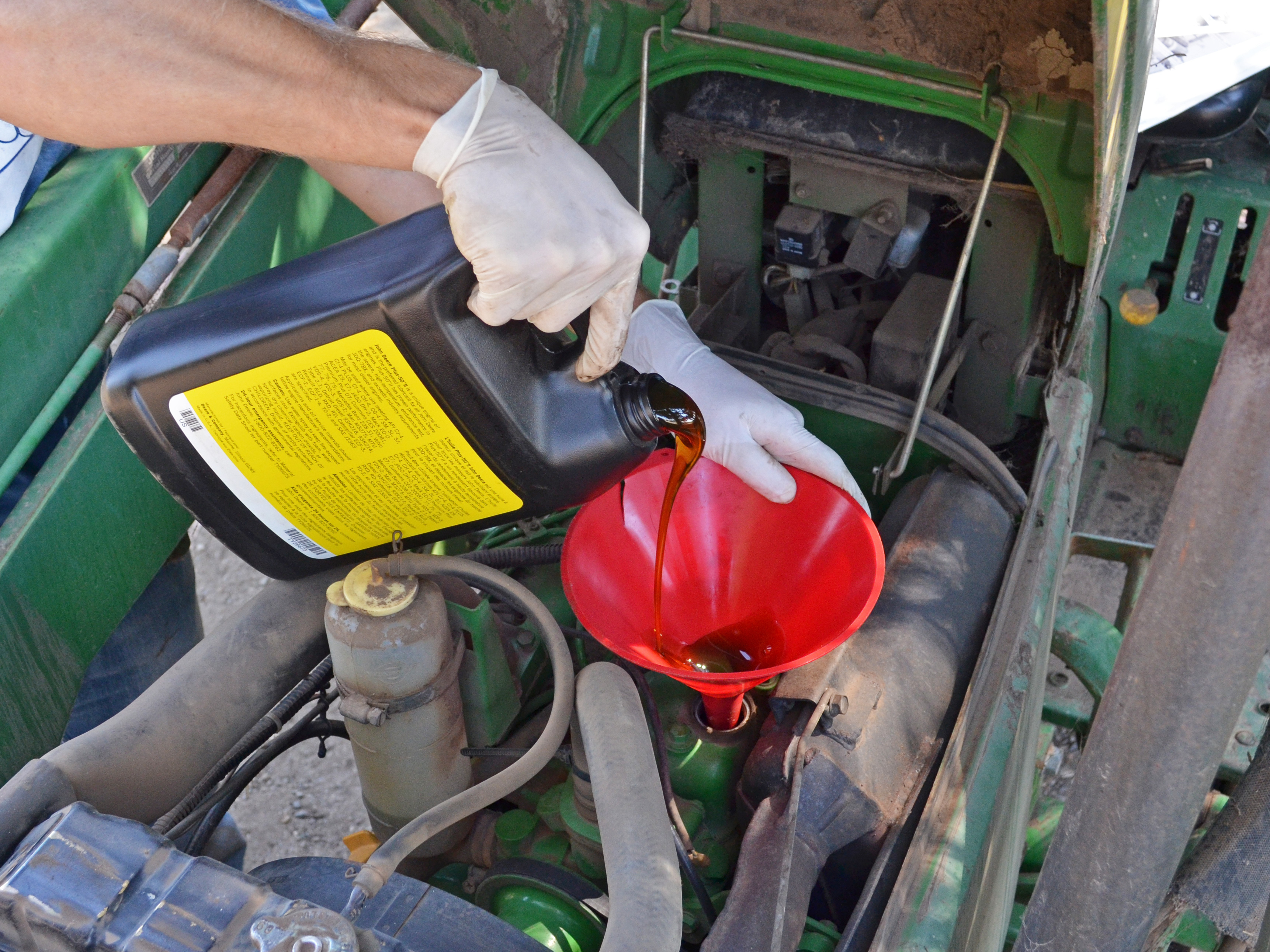

  11. John Deere 870 Oil Change: step 11, image 1 of 3 John Deere 870 Oil Change: step 11, image 2 of 3 John Deere 870 Oil Change: step 11, image 3 of 3
    • Place a funnel in the oil filler hole.
    • Hold the funnel with one hand to steady it and pour 5.1 quarts of 15W-40 oil into the funnel.
    • Reinstall the oil filler cap and turn it clockwise until it is snug.
